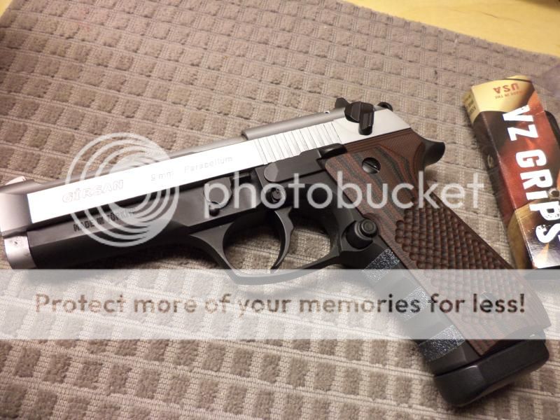

I put some VZ grips I had laying around on the Girsan tonight. I had to do some fitting to get the grips to work, but they offer better texture than the slippery stock grips. It boggles the mind why VZ would not texture the upper part of the grip. It's painful really. I also installed some grip tape. I've had good success with grip tape wrapped under the grips on a 1911, so hopefully this stay put. It felt OK in dry fire tonight.

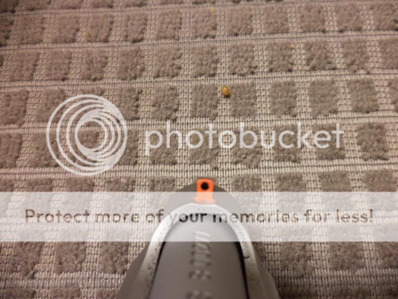

I repainted the front sight as the "black with orange dot" was not durable and the sight picture wasn't great. I like the front sight below much better and the orange Tremclad is much more durable than the black paint I had on it before. I shoot the dot with my Beretta's so, we'll see how I do at 25 yards tomorrow. The only thing that bugs me about a full orange front sight is the lack of definition on the sides as it sits in the rear notch.
