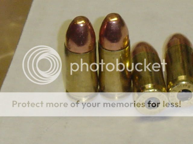

Just got my Dillon XL650 setup. Went through the manual carefully. I ran a couple of test reloads before powder/primers. I'm using 1F indoor range brass, mostly from 9mm Glocks. I know that Glocks have an unsupported chamber, so I was looking for this problem to come up. Well, it did. I readjusted the sizing die. Still unable to get brass back to straight wall. Can easily feel & see puffed out section on brass (see pic). Tried to feed a couple in to my Shadow. Had to manually force slide forward 1/16". Using Dillon dies.
My Questions:
Am i not adjusting the sizing die down enough? It touches the plate when raised. When the plate is raised to size & de-prime, you can feel the tension in the arm.
Do i need to size on a different piece of equip (Rock Chucker ?), then load into Dillon?
Use different Dies?
Use different Brass?
Thanks in advance.
Keep in mind that 9 is a tapered case...so that's not unusual. My 9 major reloads all have a slight "waist" in the middle...and I dont have any feeding problems. Yours do looked slightly bulged by the case head...but it's hard to tell from the pic.
Are you chamber checking them? If you don't have a chamber checker...just take the barrel out of your gun and use that.
