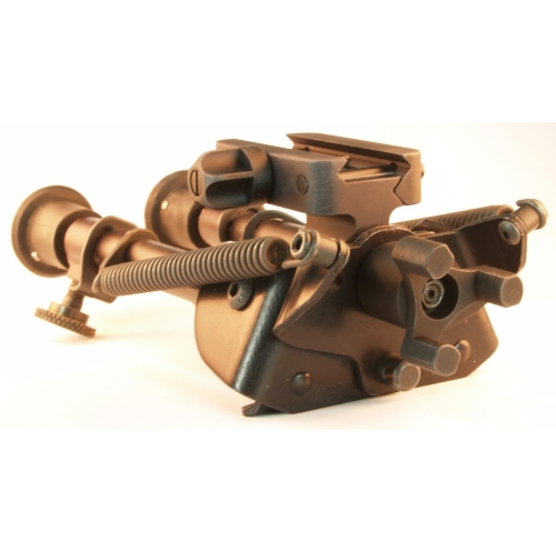

Also got the DLOC-S picattinni mount for the Harris bipod.
It works very well, but it does raise things up about 0.2". This can be negated if you get the spigot mount, which also puts the bipod a bit further forward. I think I like the SARG knob better than my podloc since it is symmetrical. Sometimes the podloc gets moved when bags like the gamechanger hit it.
Think the image above is mirrored because the lock nut is on the opposite side on mine.
