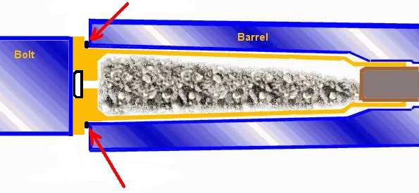

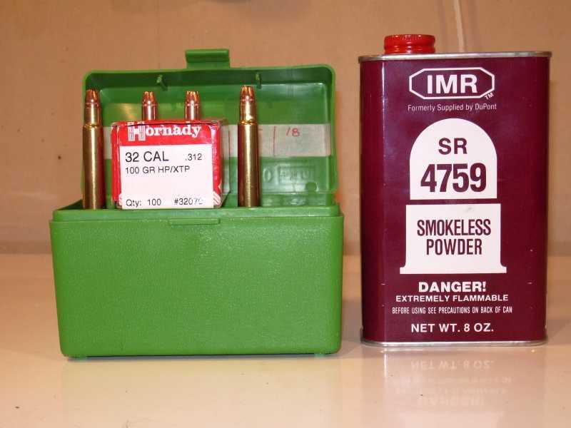

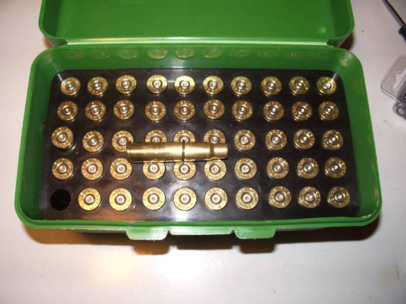

I use 100 grain pistol bullets or the lightest rifle bullet I can find. SR4759 was discontinued so now I use Trail Boss powder and not worry about double charges of fast pistol powders. I also use these loads to fire form the cases using a thin rubber o-ring.
After the case is formed to the chamber the case will headspace on the shoulder and not the rim. And this will prevent case stretching.
I'm using same load as bigedp51 pistol bullets are plentiful also been using 125gr plated bullets with trailboss can get 500 of those bullets for 77$
