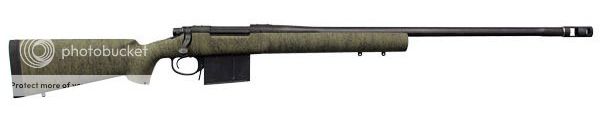

My rifle....

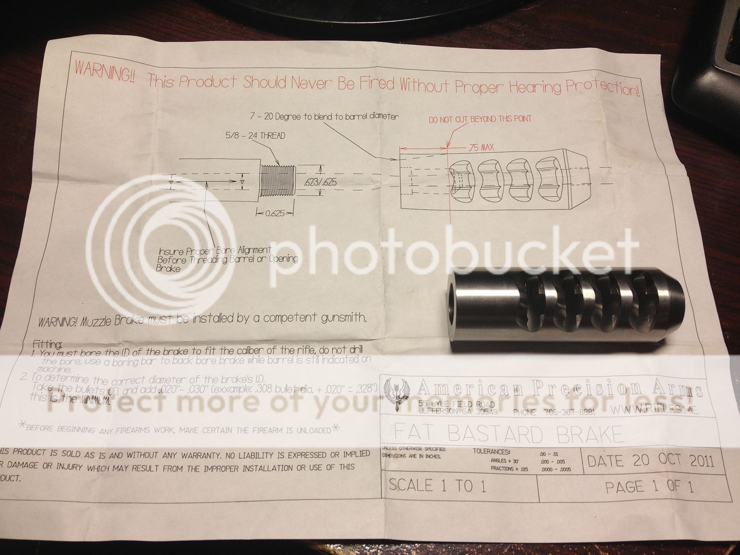

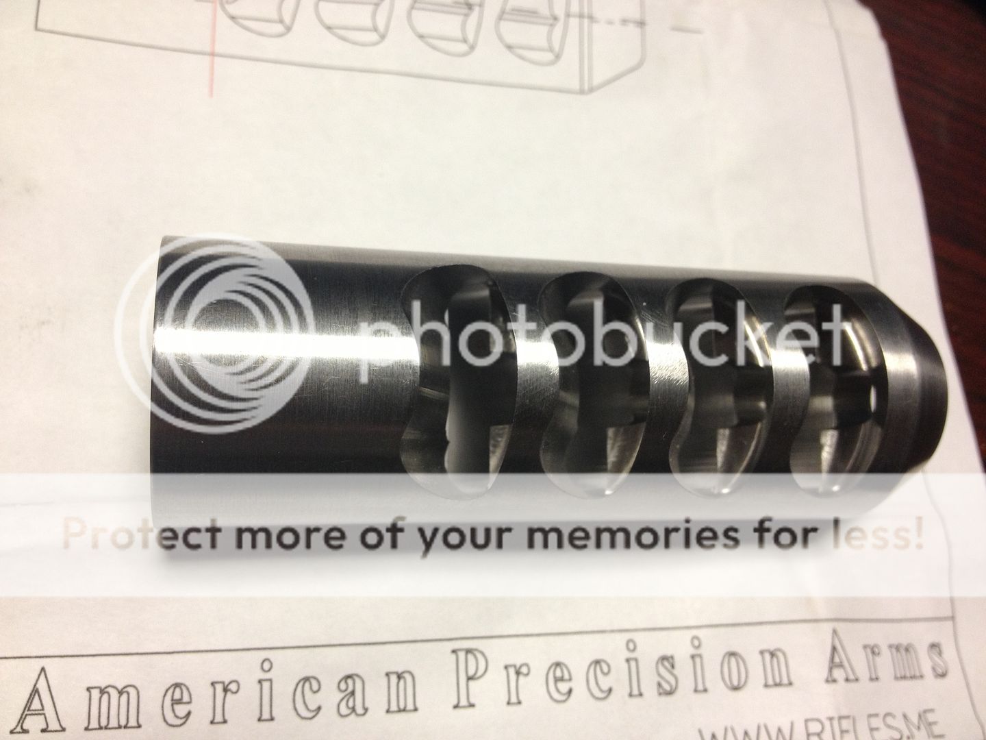

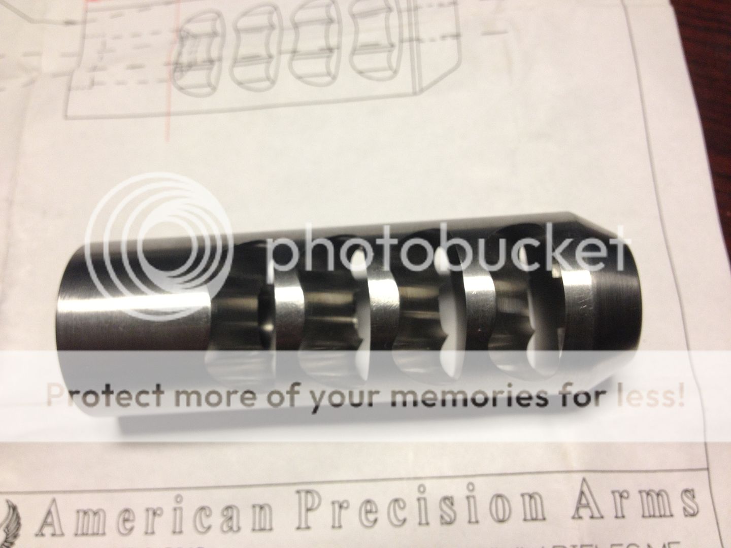

Both of us intend to have the action bedded, and both of us have purchased replacement muzzle brakes due to the factory brakes kicking up a lot of dirt, small children, and dust. (Both of us happened to separately choose the APA fat bastard)

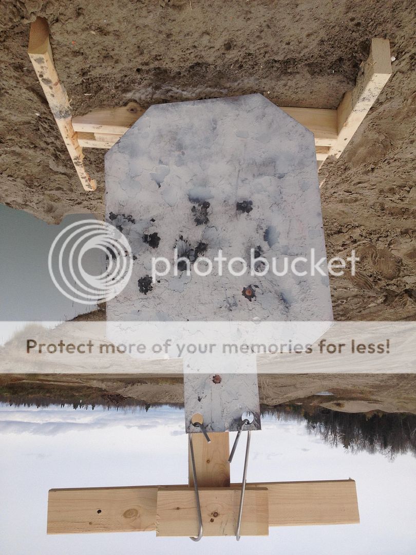

With my MLR and 270gr Lost River Ballistic Solid copper bullets, I made a perfect headshot on steel at 900 yards in 4 shots (2 to get on target, 3rd on steel aiming center mass of torso, and a final wind and elevation call to get the headshot), a feat that was almost precisely duplicated later that day by the gentleman with the XCR and hot 300gr SMK handloads, but I didn't get photos of his target.
Here is the hit from my shot, which he duplicated with very close to the same number of shots... My hits are the copper coloured ones.
