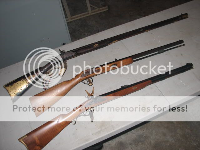

For comparison these are my wife and daughter-in-laws rifles.
Top one is a 50 cal Lancaster with a 36" swamped barrel.
Middle , 50 cal CVA 26" X 15/16" barrel
Bottom, 45 cal T/C 25" X13/16" barrel
The Lancaster is beautifully balanced, haven't met a lady yet who couldn't shoot it.
The CVA of the three is the most "front heavy",
The T/C , any lady could shoot this one also.
My D I L finds the CVA too heavy, but has no problem with the T/C
My grandson also shoots a shortened T/C, but uses X sticks .
