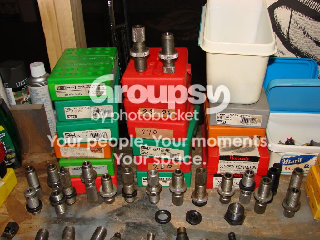

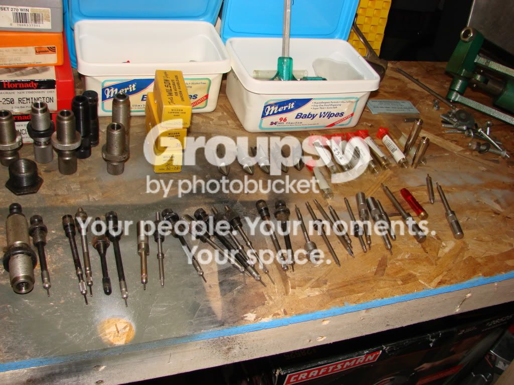

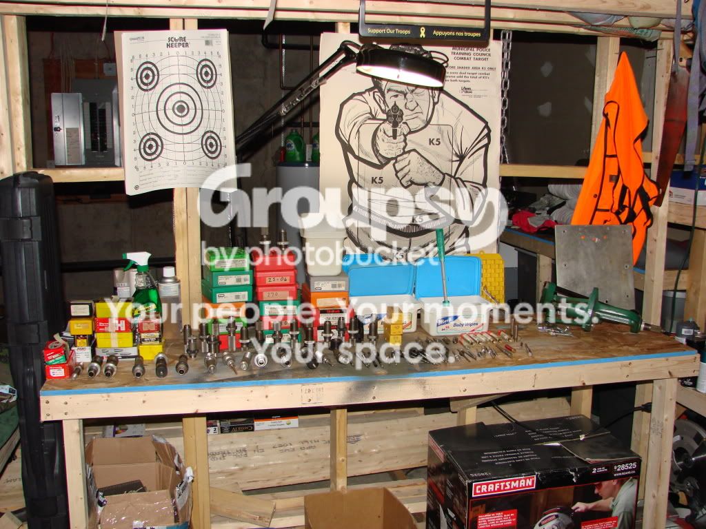

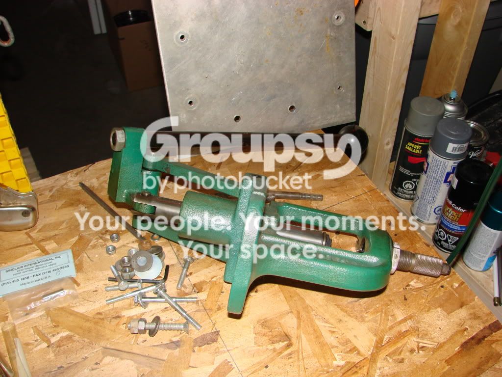

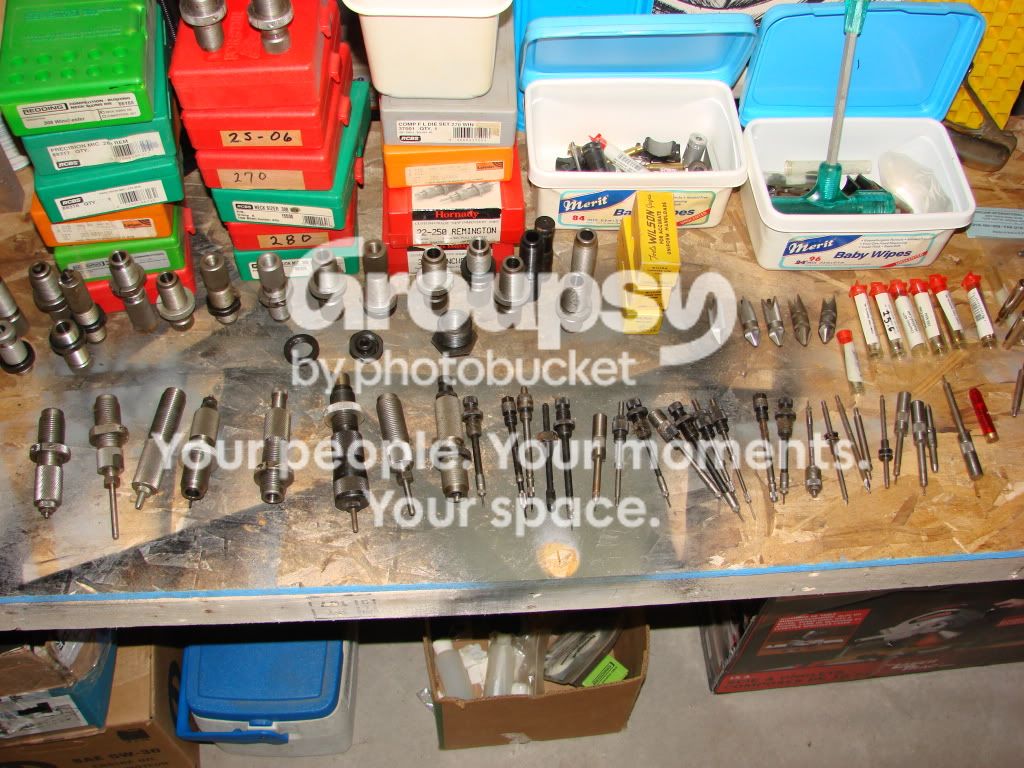

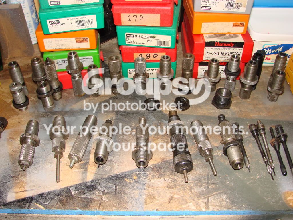

The other day he shows up at my door with 3 boxes and a Coleman cooler. Not sure what was going on, I helped him in with the boxes and opened them up. To my surprise this is what I got...
Wow. He said he kept all this stuff for me. In'till I got interested enough to use it. ** Not sure what a lot of it is yet, I only reloaded maybe 40 brass with him in my life with him holding my hand along the way lol **
All I need now is some trail and error on how to use it. And I am rocking. There is also another 3 or 4 boxes of Powder, primers parts and pieces that I don't have yet.
I was floored when he just gave me all this stuff, Cause I know none of it is cheap!
P.S ** What is a good way/product to clean all the dies? In some of the pictures its looks like rust, But they have grease dirt and cat hair on them. Make a parts bath out of degreaser?

For a start, I'd try cleaning the dies with WD-40 and a clean rag. That should get rid of the dirt and minor rust as well as protect from future rust.
I recommend you get a couple of good reloading manuals such as put out by Harnady, Lyman,etc. and study up before you try to do any loading. The loading of ammunition is NOT something to learn by trial and error. An error could be your last!

After you clean up the dies etc.One job you will have is to identify the various
expander buttons. Best tool for this would be 1" micrometer, After a while get yourself a 6" vernier caliper, these tools can be bought fairly cheaply nowadays.
Your brother may have given you these tools, check your kit.

AJSP, looky like you may need to fire up the chop saw and cut a couple more
legs for the bench you have there. ;)

You'll have fun figuring out all those decapping dies. Who ever took them all apart, left an interesting job for someone to put them back together.

Clean 'em with WD, OK. Expect to find them all rotted and rusty, if you depend on WD-40 to protect them. The stuff is mostly Stoddard Solvent. Varsol type stuff. It evaporates and then the nice clean metal that was not protected by the little bit of oil that is in it, rusts.
The stuff is crap, really. WD, in the name, stands for Water Displacer. 40th formula they tried. thus WD-40. Use it as a way to chase water out of electrical parts, but fer th' love of pete, don't call it oil.
Get some oil. LPS-2 works OK, Boeshield gets good reviews. Dipping the stuff in straight-weight 10 or 20 weight oil is fine too.
Use the WD-40 for lighting fires, and as wash juice. But oil afterwards.

I also am not a fan of WD-40. Instead try Red's cleaning formula-mix equal parts
1.Automatic Tranny Fluid
2.kerosene
3.solvent
4.acetone
Use a toothbrush and/or 0000 steel wool to scrub everything clean. The last 3 ingredients will evaporate and leave a thin coating of ATF which is a great rust preventer and will not gum up with time.
some nice looking treasure there, some interesting stuff to.... neck dies and the like.
I would use a stiff brush and a can of "brake clean" followed by compressed air. Once they are clean and dry a shot of G96 followed by another shot of compressed air. The air will force the G96 into the threads inside and out.
1 gallon container and 2/3 liter's of gas work's also.
Put it all in there for a couple day's then pour it into another container to re-use the gas and fish out the part's.
