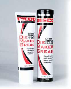

I have always used Lithium Die Makers grease on slides; especially during break in. Once it is broken in, since is is likely going to cycle less than 1000 times at an outing, any good gun oil is fine. We use it in the die shop an everything that slides back and forth at, high speed, under great pressure. It stays put and is quite clean to use, and improves longevity; and you don't need much more than a thin film. Apply it, cycle the slide a bunch of times, wipe of the extra on the exterior, and you are good to go.
