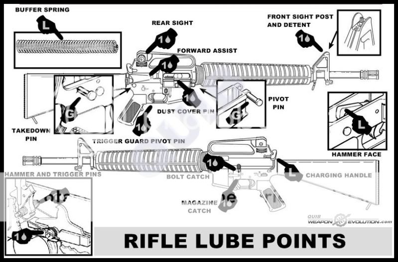

Oh ya White Lithium grease the spring buffer and add high heat wheel grease to the area shown in the pic below.
L stands for lube and G stands for grease.
(*If your firing pin is chromed NO OIL*)
