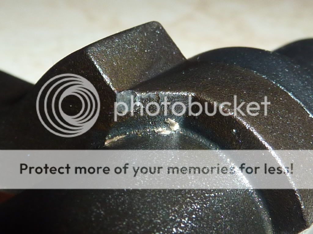

this pic caught my eye.
all of my remington 700s have this to some degree. is this not normal?
hate to partially derail this thread, but anyone????
could someone with a 700 check their bolt please for this spot of wear?
all my 700s (3) have it, but now you guys got me all paranoid that its a 'bolt timing issue' :runaway:
Its from hard camming the bolt. Don't worry about it.

so even if it wears further theres nothing to worry about?
whats interesting is that i worked the bolt while examining the area with a flashlight, and aside from that one spot where it hits there seems to be hardly any contact with the rear camming surfaces at all: theres nearly a mm of space between them. seems like nearly all the camming action is coming from the front of the bolt on all my 700s.
after watching this video im starting to see why bolt timing, receiver blueprinting, etc is necessary.
[youtube]CjpWYmLpZA0[/youtube]
is this type of thing eliminated on custom actions or a blueprinted 700 action, and there is proper front+rear cam contact and no uneven wear?
