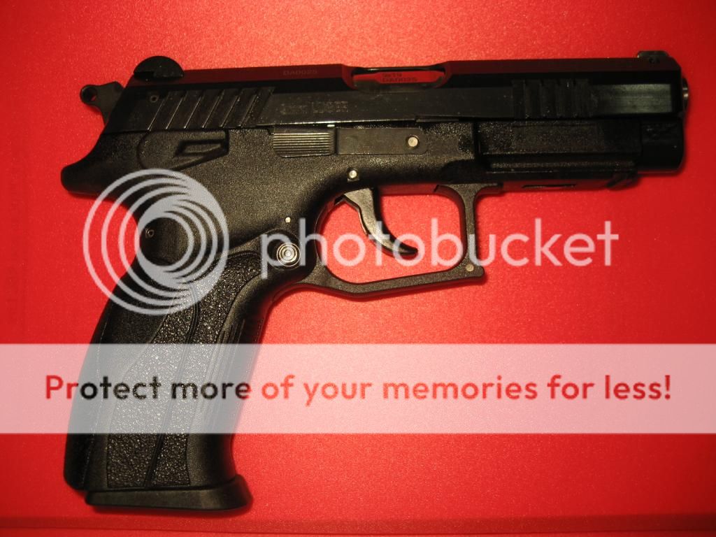

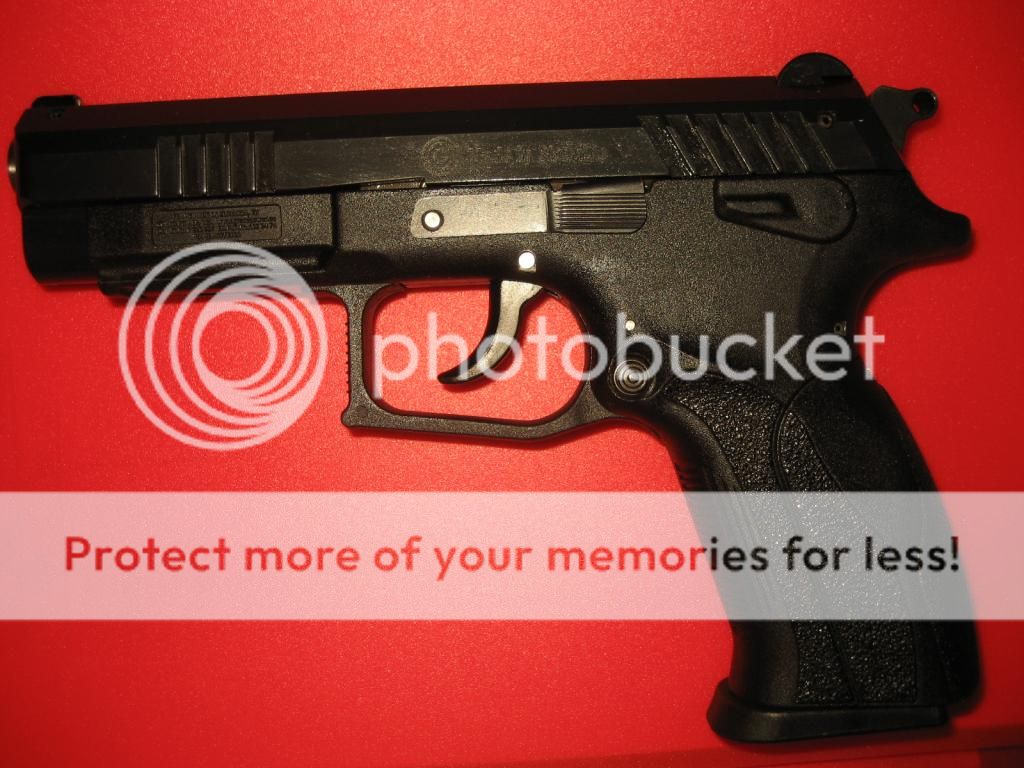

I unboxed a new pistol that arrived just as I was leaving for the range. I took it with me and fired two loads (lead bullets). Both grouped well.
I bought this real cheap on EE. But even for $100 more, this is a very good pistol.
It is a full sized polymer framed 9mm. DA/SA The DA is fairly smooth. The SA is perfectly light and crisp. Nothing like a M&P9 or a Glock.

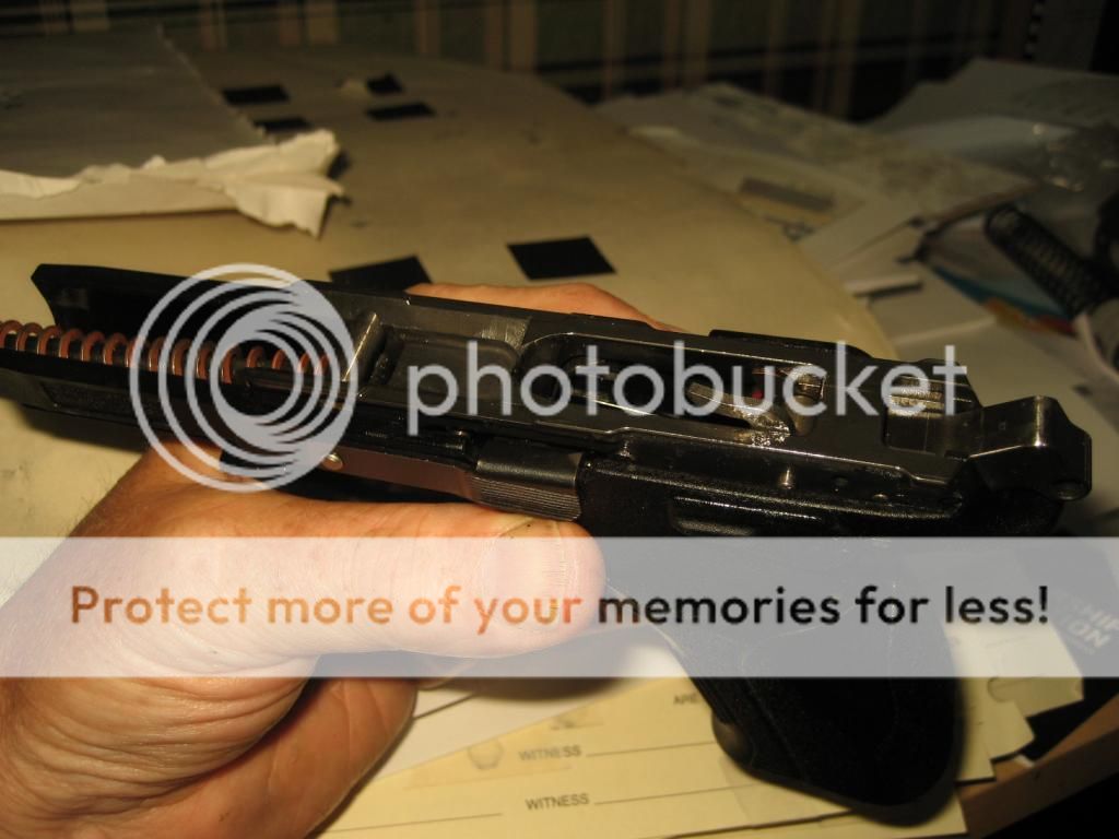

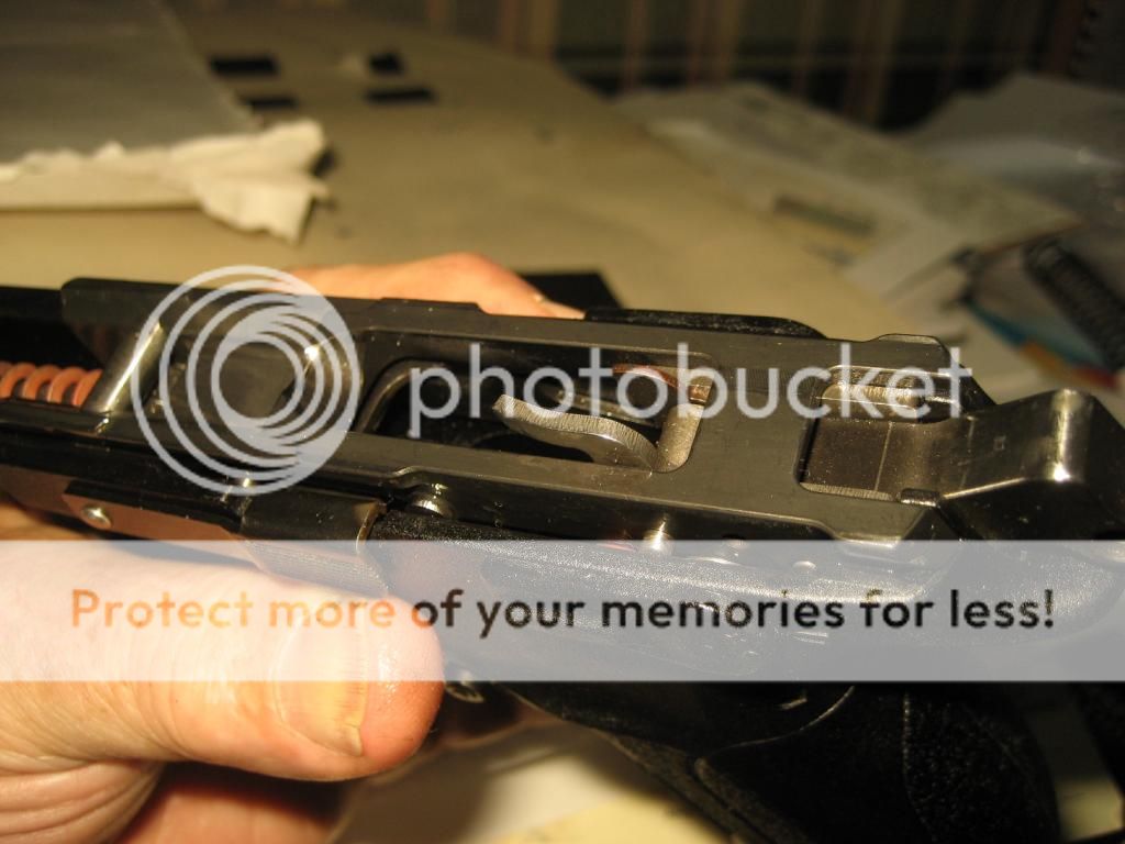

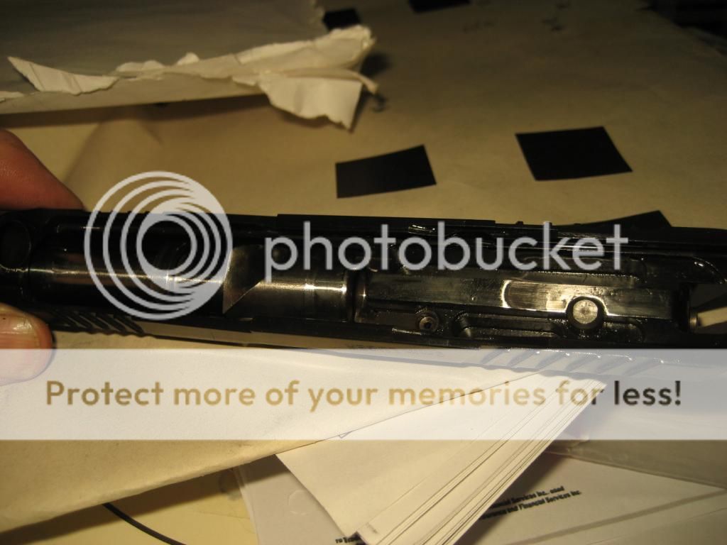

Inside I found everything very well finished. Nothing like a Norinco. Fit was tight and slick.

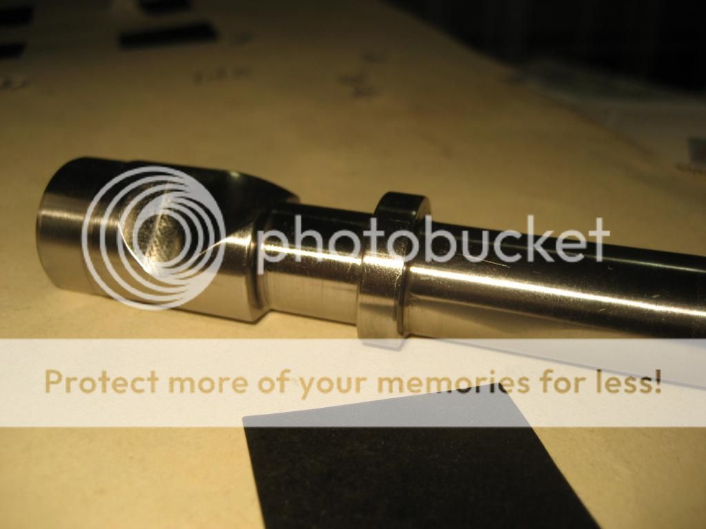

The lock up is via a rotating bolt, rather than some variation of a Browning design. This puts the barrel slightly lower in the slide than the others.
It has a safety, much like a 1911, but not quite as easy to use. No decocker.
Mags don't fall free. They fire out!
Takedown is simple. No levers to turn or pins to pullout. Just pull the front of the triggerguard forward and pull the slide back and up. Just like a PPK.
It has a replaceable back strap, available in 4 sizes, but these are not included in the guns sold in Canada. Unfortunate, because I think this is an important feature. I bought 4 from Dlask for $50. It appears that the included grip is "Large". I tried one size smaller and the pistol feels better. And I have a fairly large hand.
I own a lot of pistols, and I would rank this the best economical pistol I ever bought. It might yet prove to be the best pistol - period.
