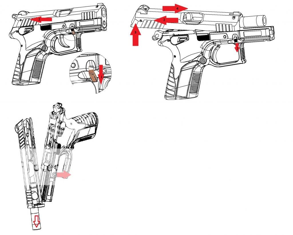

I wish I had copied the the manual before I sent them back today. The picture in the MK7 manual looks just like the 53GR image. Even if my eyes decived me and it was only as far as you say, that is a small margin of error. That is a 0.65 centimeter difference from safe to catastrophic failure. J & G said they looked at 50-60 guns they had in stock, and did not see any others with damage. They also said that with the exception of one gun, all the others had serial numbers much larger that the two I received. If it turns out to be an isolated occurrence, I will be back, because the gun felt great. BTW my serial numbers were 1k-003## & 1k-003## one number apart in the 300's.

bjs7293, they run 430-500 usd. Thanks for the video Canuck223, is that a MK6 or a MK7 gun that you are using? Grand Power & Century Arms need to remake their manual or add a disclaimer about the trigger guard. I found a copy of the manual at http://www.centuryarms.com/manuals/pdf_flipbook/K100, K100 X-TRIM, P1 Pistol Manual/index.html It shows how they want you to take the gun apart. The guard on our guns would not stay out like in this picture. I took 2 sceen shots of this manual and it shows the trigger guard all the way out like the 53GR image.

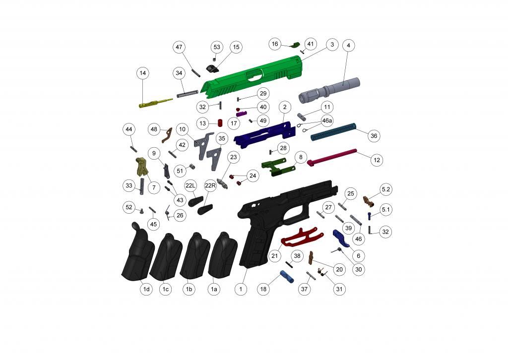

If I had a video host that could accomodate a big video file, I have a factory video showing how to change out a trigger guard.
It's not hard at all. The biggest issue is the mag catch tube. I'm sure in a pinch you can get it in and out without damage, but the factory recommend making a tool and show the dimentions. It's just a rod turned to the right diameter with a slight collar, to protect the tube from distortion and the frame from damage.
After the normal field stripping, you press the mag catch tube out from right to left.
You use a punch to press the trigger guard pin out from right to left.
You pull the trigger guard out.
You install the mag catch into the new trigger guard using a short assembly pin.
You install the trigger guard, and tap in the mag catch tube.
You tap in the trigger guard pin and drive out the assembly pin.
4 minutes work if you have the tools.

Crack on the frame could happened by trigger guard not being snaped back into position while shooting. It is impossible to damage frame by field stripping the pistol. Trigger guard also works as buffer and absorbs recoil impact, so it needs to be replaced after about 20 000 shots. To avoid accidents like this in the future, new conception of the frame have been developed and will be available soon.

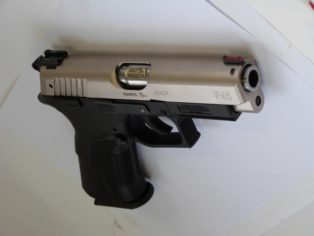

Love the finish on that .45 slide......
Yep, I like the tri-top look of the 9mm's, but this does appeal to me. It also has a new front sight style like the X-Caliber. Don't know if this will be the new format, but it does make it easier to make different width front sights.
