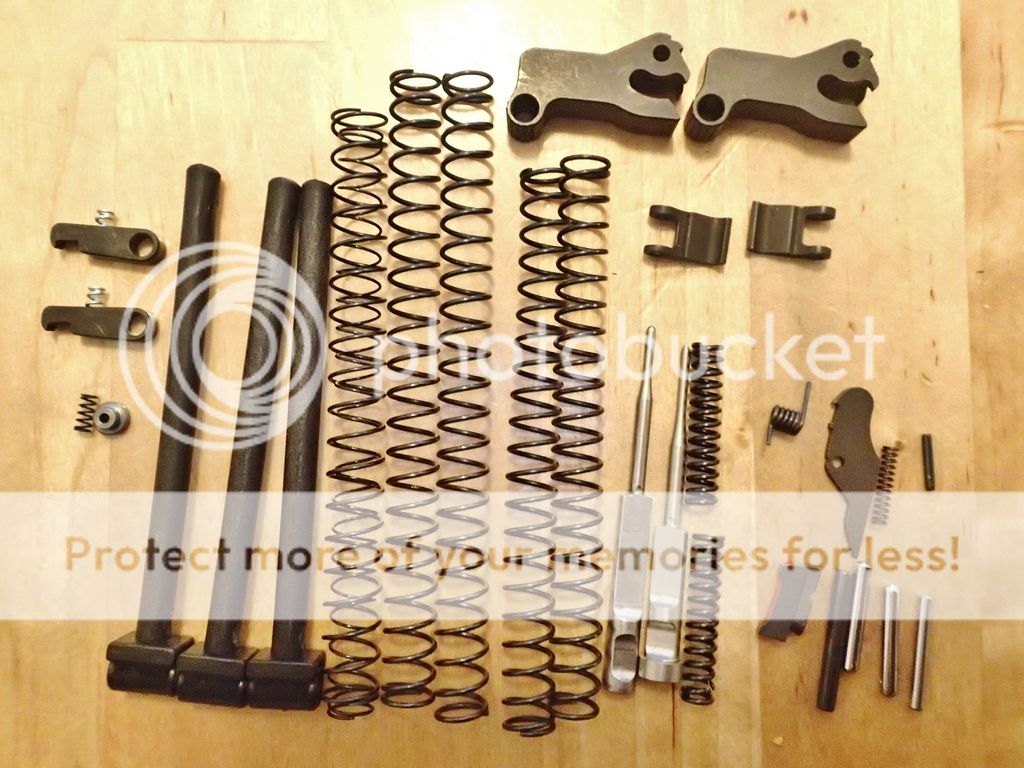

An update to the Grand Power spare parts saga. For those that may not know, David Copping (Grand Power Canadian sales rep) has taken over as the Canadian distributor for Grand Power and recently got in his first shipment of parts a week or so ago. Here's my goody bag from David. Only really needed to replace the slide recoil spring and the firing pin retaining pin, but just like to have spare parts around :)
