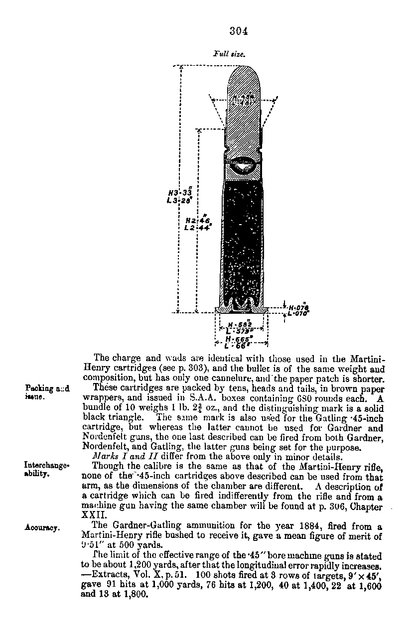

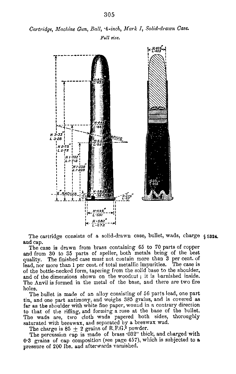

Firstly, I see that the .45 machine-gun cartridge diagram does, indeed, have a bottleneck ..... although it is much less pronounced than the dramatic diameter reduction of the .577/.450 neck .... (Mind you, in my own defence, I did modify my comment in that regard by saying "or nearly straight-walled" - which would seem to be a fairly apt description of the cartridge profile illustrated in the Treatise ....) i.e. the "Cartridge, Machine-gun, .45-inch (Mark III), Ball, Gardner, Gatling and Nordenfelt, except Martini-Henry chambered guns" as described starting at the bottom of page 303 (see below) and illustrated on page 304.

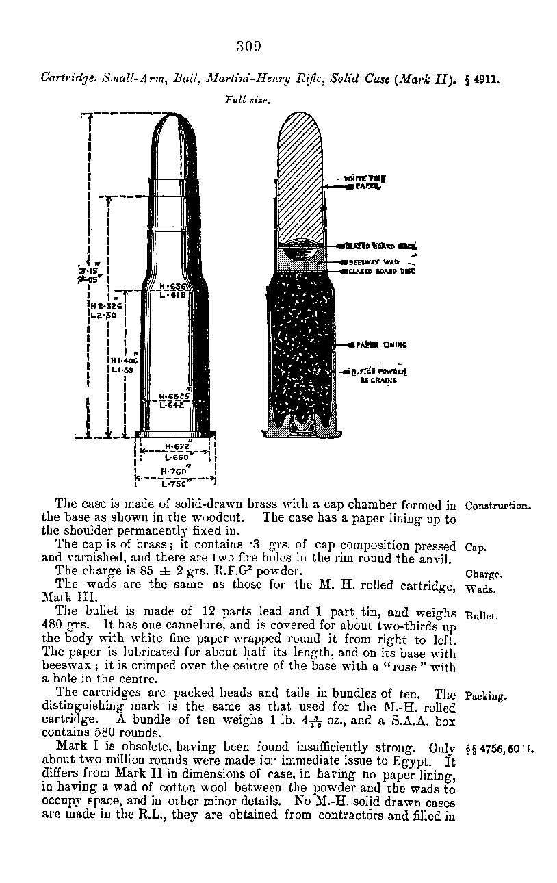

For the heck of it, and assuming some of you may not have access to the 1887 Treatise on Ammunition - which certainly should qualify as a "primary reference" for this discussion - I have scanned the pages which seem relevant and now link to them here - i.e. the entire "Machine Gun Ammunition" section of Chapter XXI and the first few pages of Chapter XXII ..... Definitely no "copyright issues" with material this old!
