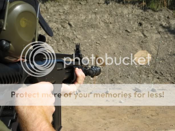

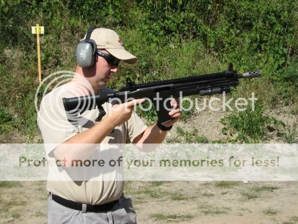

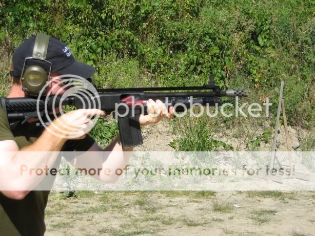

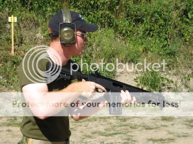

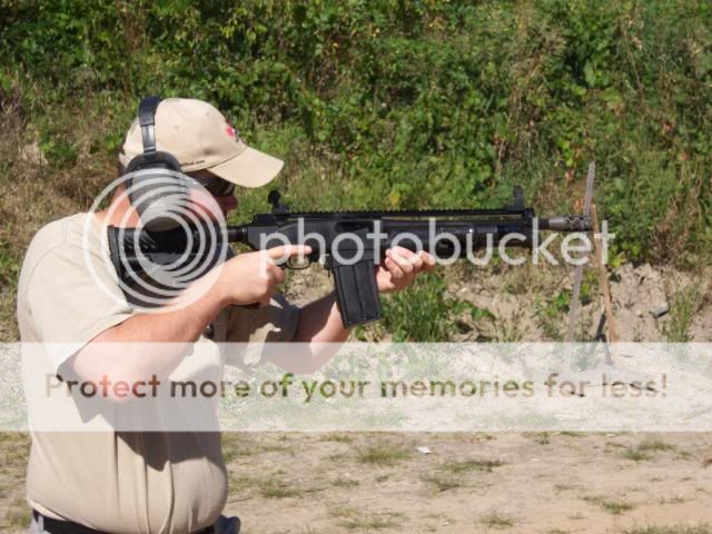

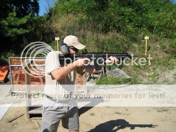

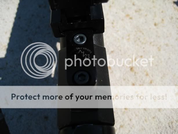

Grizz Mag 870 copy range test.
The stock adapter, as well as the rail. He also manufactures sling plates, and sells forends, buttstocks, pistol grips, slings, breaching barrels, and a couple other additions for your shotguns. Check out his website for pricing: S&J Hardware

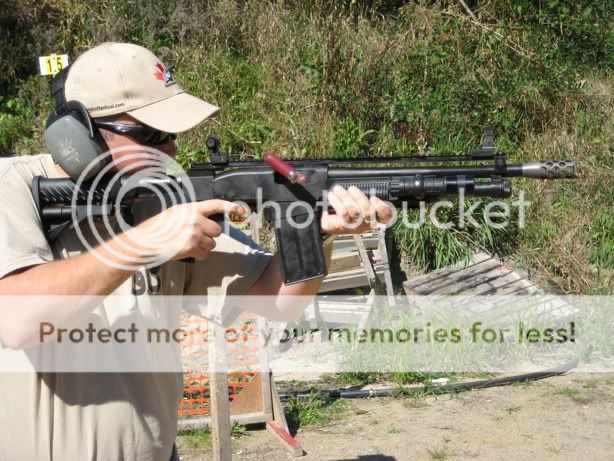

What modifications did you need to do to the Grizz Mag to get the CQB 870 adaptor to fit? It looks like you took off the rear sights from the mag, and BBB mentioned in the long Grizz thread that the barrel is a 14 incher instead of one from the other Grizzlys. (Out of curiosity, would the sights work at all if you swapped barrels from a ghost ring sighted grizz to a rifle sighted one or vice versa, or would they need to be replaced?)

I have not built a CQB Griz mag fed yet. I have plans to but at this point I have not.
While I have not done this, it is my understanding is swap out the barrels and remove the reciver sight (its drilled and tapped to the reciver), and plug the holes, install the adaptor and rails.
I have no idea if the reciver sights would work with another barrel/front blade combo. The best way would be to measure the existing front blade and measure the new one for comparissons sake.

What exactly is the problem with using the original Grizzly 15" mag fed barrel with the CQB adapter. Is the barrel too narrow or too thick? Is there any way to mod the CQB adapter to make it fit?
no problem at all, right at where the iron site is on the 15" barrle is where the barrle clamp must go, os the front site needs to be cut off.
2 mins withthe dremil tool and cold bluing, you weill never see it as the clamp gos right over it.
bbb
Mostly just curiosity. It also looks like the 12.5 inch barrel would be flush with the pump on the Grizzly Mag
