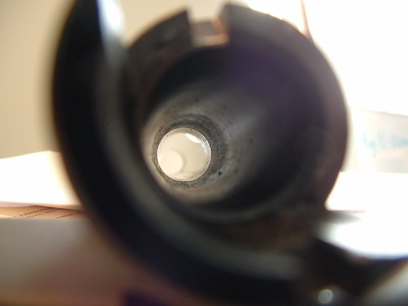

I got my new ghost ring sight, 12.5" barrel, removable choke Grizzly last week. I did the usual clean and inspect before taking it to the range. Part of my pre-shoot check included removing the choke tube and cleaning and lubing the choke threads with synthetic grease. Both the choke tube and barrel threads appeared well made and the choke tube screwed in smoothly.
I fired a box of 1-1/8 oz target loads first, and when they were gone I took the choke out to see if there was any plastic fouling on it. It looked fine so I re-installed, it screwed in smoothly.
Next I fired a couple of boxes of slugs. When I got home I got to cleaning the barrel and of course I tried to remove the choke. It did not want to come out using a quarter for a wrench, despite a fair bit of force. Hmmmm...
Using a "T" type choke wrench that I have I was barely able to unscrew the choke from the barrel. I tried another choke and it screwed in without problem, so it looks like the barrel is ok. However the choke that came with the gun appears to have deformed at the bottom, the base of the choke looks to have been pushed out and because of this it was almost locked into the barrel. Another box or two of slugs and I doubt that I could have removed the choke tube.

The choke in my Grizzly became deformed at the rear, where it was already bigger than the bore diameter of the gun. Perhaps this tube was made of steel that was a bit too soft or has not been properly heat treated.
