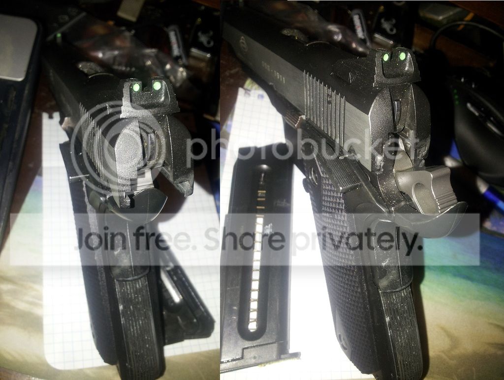

This?
Now I see what's going on. I'm missing a part. The little rectangle piece that sticks out that the hammer hits when you fire. Where the hell did it go??
Yep. Took it apart & sure enough the firing pin is broken. Al Flaherty in Toronto has the replacement kit in stock. Good day to jump on the Harley & go for ride.
