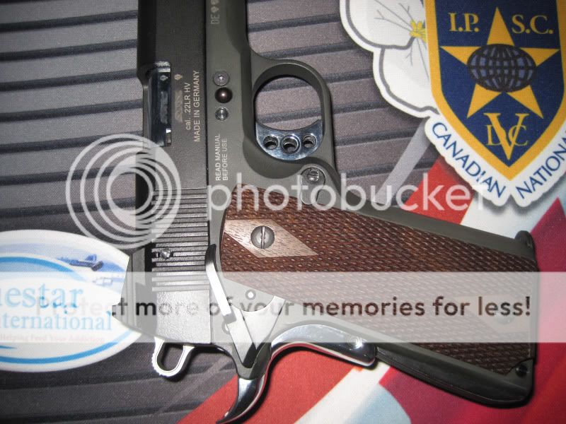

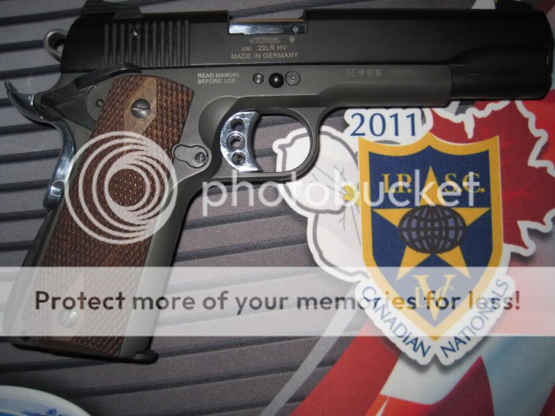

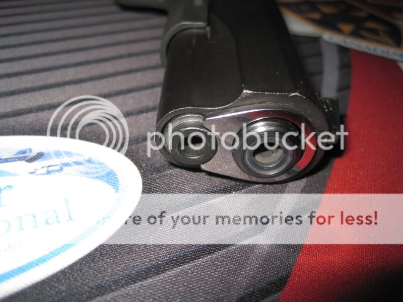

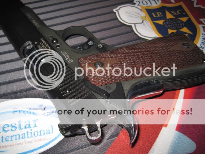

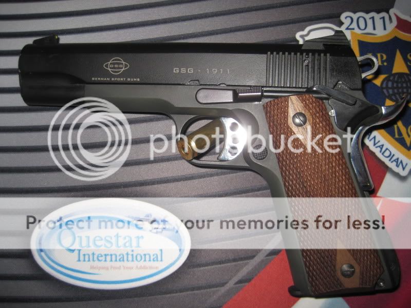

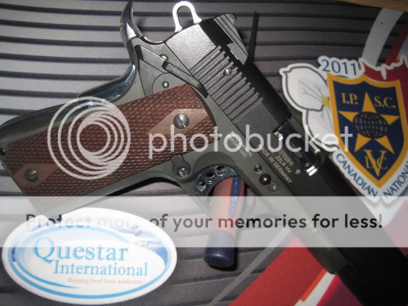

I've been liking mine so far too. I found the grip safety pretty stiff at first so I ended up taking it apart to see if I can make it lighter and ended up going a little foolish with the metal polish, lol. I ended up polishing the exterior of the chamber, the grip safety, trigger/trigger bow, barrel bushing and touched up the leaf spring tips and the contact surfaces on the hammer, sear, and disconnect. I also tuned the spring a little. Huge difference in the trigger, I honestly think polishing the trigger bow made the biggest difference to the pull. I could probably get it a lot lighter than it is, but being my first time trying a trigger job on a 1911 I figured I'd take it a little at a time, lol.
Here's a few pics of how it looks now.
