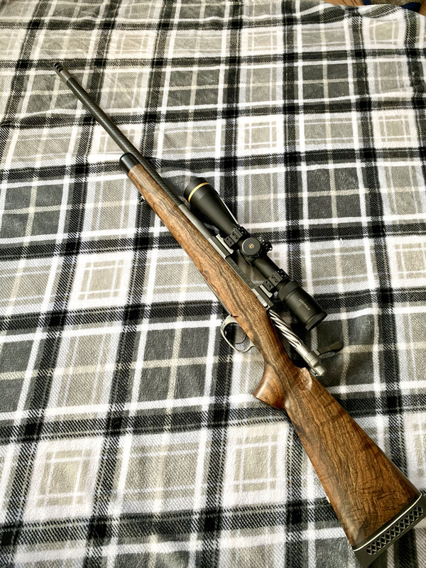

[/url][/IMG]![]()
[/url][/IMG]![]()
Looks like you did a nice piece of wood (2 piece set) justice. Good work!
