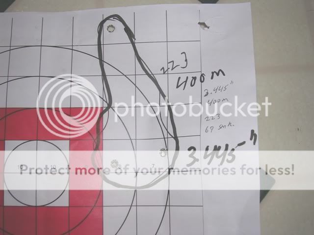

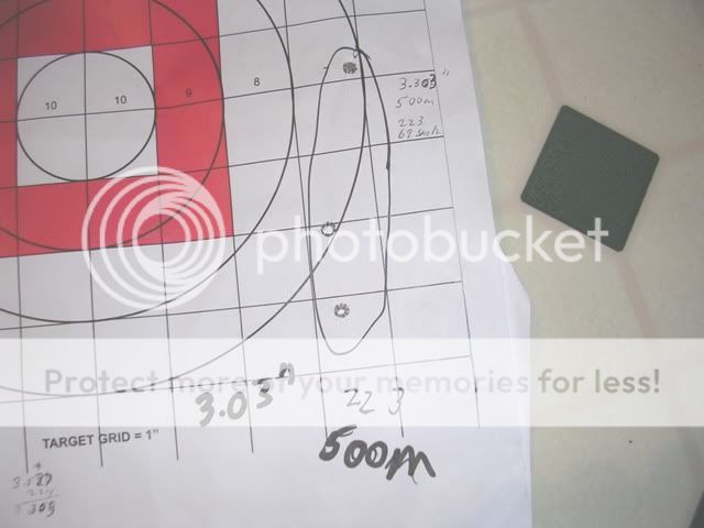

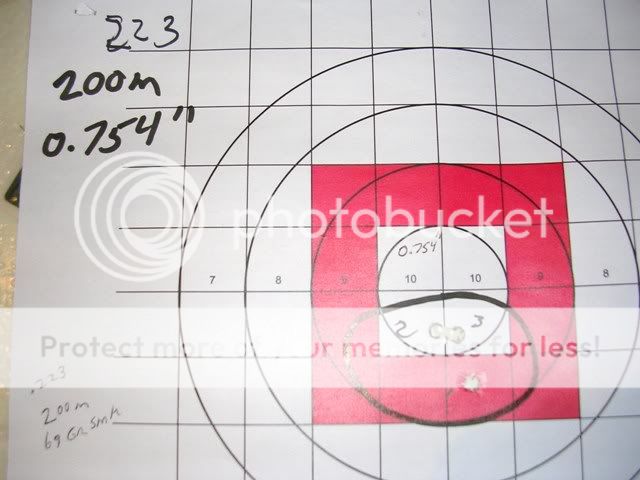

I had the VLP .223 out again yesterday. I've got it dialled in pretty good out to 600m. The little fixed 10X 3200 s a little light in magnification at that and beyond so I've been chatting with Jerry about a Sightron, also about scope tracking as my 600m group was 6" right of the bull (no wind). The 600m 3 shot group was 4.50" but was just off the paper so I didn't get a pic. The rest are below. So far it's maintaining .75 MOA out to 600m.

A few things I would consider when looking at your group due to the amount of vertical stringing.
1 - can I see the target clear enough to keep POA within 1/2"?
2 - am I getting any bounce from the bipod? Inconsistent follow through will definitely cause vertical
3 - what type of primer? CCI 450 is my choice when it gets cold
4 - tune the load for the colder temps. Even extreme powder needs to be tweaked when cold or hot. 0.1 to 0.2gr can make a huge difference in vertical. Try raising or lowering the load a tenth or two and see what you get.
Looks very promising and if you can dial out the vertical, that rig may just stun you with what it can do.
Enjoy...
Jerry
Sounds good Jerry. I need to load some more ammo tomorrow, I'll tweak it up .1 or .2 and see what happens. Also with that fixed 10X I was covering most of the target with the reticle at 500m. The red square on the target is just shy of 4" (scanned and printed my own)
Make the target just slightly bigger then the reticle so you can see the shadow of it when the reticle is aligned properly. Another colour helps too.
Mag doesn't matter as long as the target is sized to suit.
I am blown away each time I see what TR shooters can do with open sights but the target is sized to their sights (or the other way).
Definitely, tweak your load. If the bedding is correct and load tuning correct, that rifle should shoot 1/4 min vertical. The group size may be closer to 1/2 min horizontally but the bullets will land in an ellipse (football on its side).
If the groups expand rapidly, then go the other way 1 or 2 tenths.
Let us know how you make out.
Jerry
