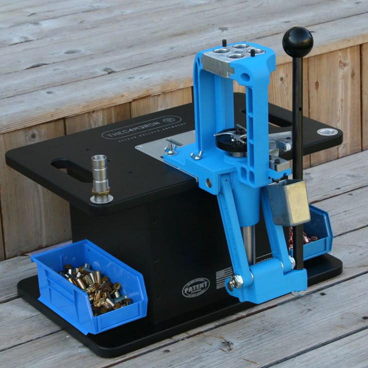

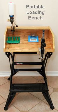

Not sure what your budget is (if any) but here are some ideas. Find a cheap old press (or new) and put it on a portable bench. This way you can do your reloading in front of the t.v, doghouse, outside, etc.
Cheap option:
Expensive option:
more ideas/links:

Frankly if you want to load in the same room so you can still converse in some limited way and just be there for companionship I'd strongly suggest something more like the compact setups shown in Greenbob's post. And on top of that I'd also suggest that you set it up off to the side so your constantly moving arms are not distracting to wifey as she's watching her favorite show. Even so you'll want to run the press and manage the brass in a slower and measured pace to hold down the minimal but still annoying noise that would occur even on a single stage running at full tilt. But you should still manage to run off around 120 per hour.
If you don't mind buying a Dillon square deal or 550b as shown in that last picture then even running in "silent mode" you can produce around 250 rounds per hour I'm thinking. In full speed mode I can easily produce 350/hr on my own 550b. But that's only with a lot of brass jingling and bullet bumping. So I think that running in silent mode would likely reduce that by around 100/hr.
