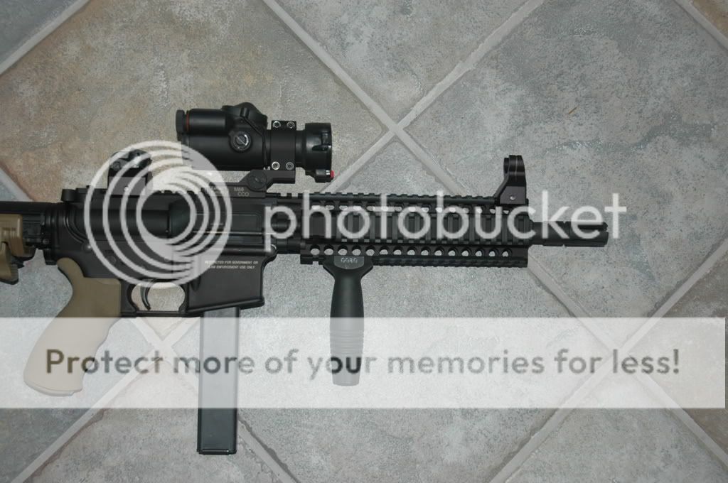

Here are the differences with 9mm AR Lower and rifle caliber
Mag Block
- you can get a RRA, C-Producs, Hahn to run "Colt" style mags or modified UZI
- you can use a VM Hytec that utilizes UZI mags
The exception being the Hahn dedicated model , all the Hahns, RRA etc install very easily. If it takes you more than 1min you are doing somthing wrong
Hammer - there are dedicated 9mm hammers but in reality you can have your bolt ramped . This way you can use any FCG you want. My 9mm upper runs on my CMC trigger , RRA 2 stage and Geissele lowers
The buffer is heavier as well but you can change that every easily ( or you can run a heavier buffer with the rifle uppers )
