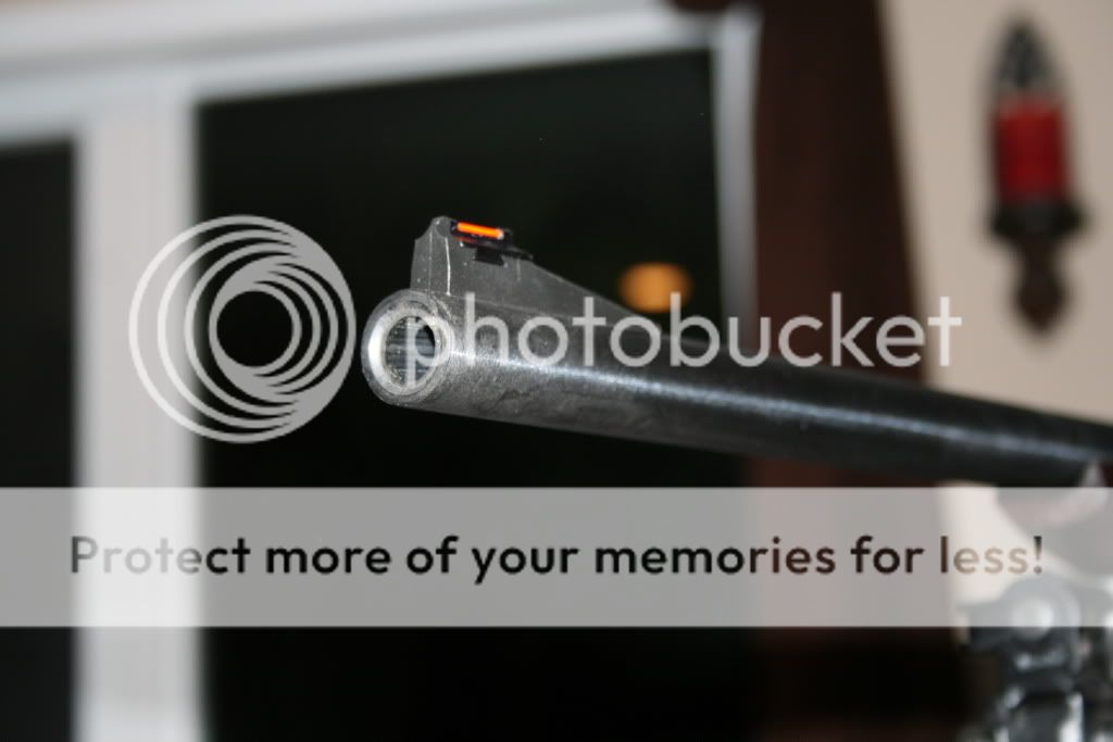

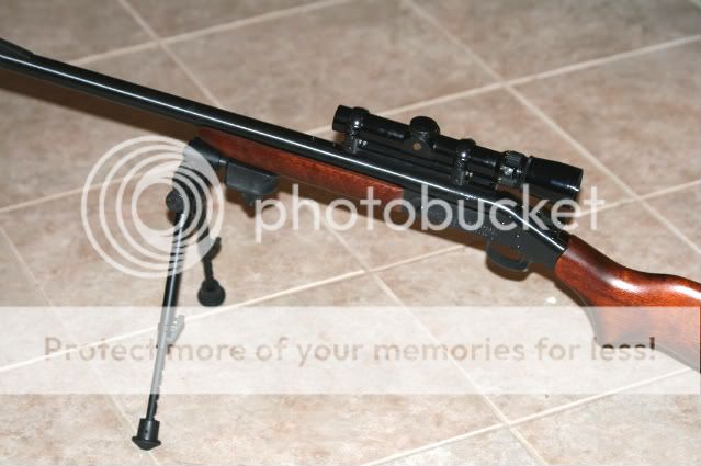

This followed me home today, my wife thinks it's cute:eek: wait till she shoots it!!
Range/recoil report soon.:sniper:
500SW 44Mag

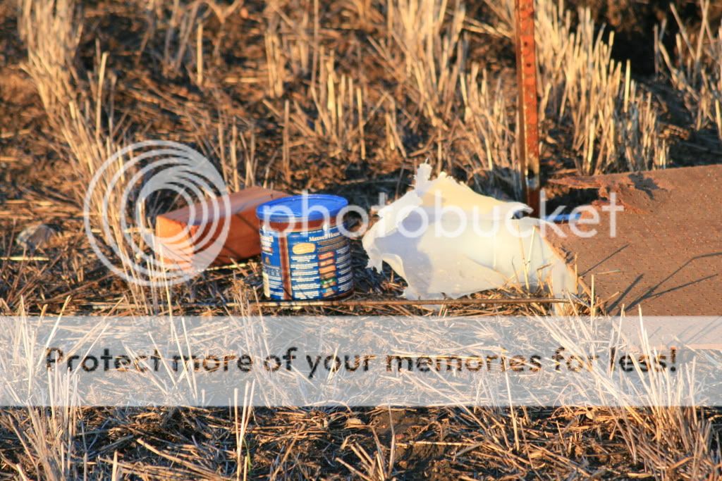

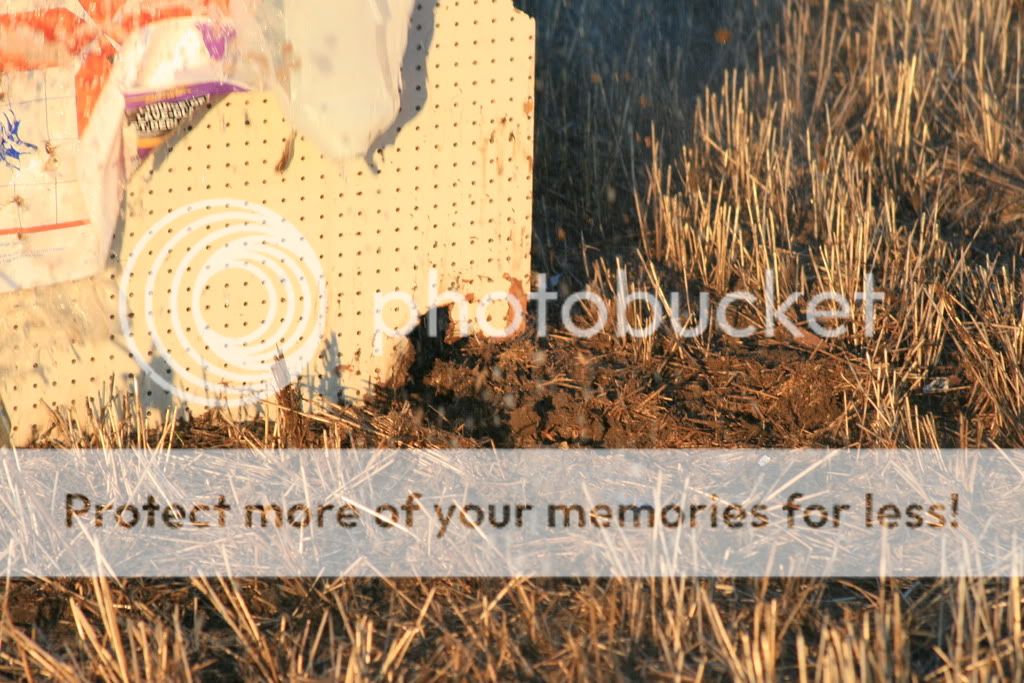

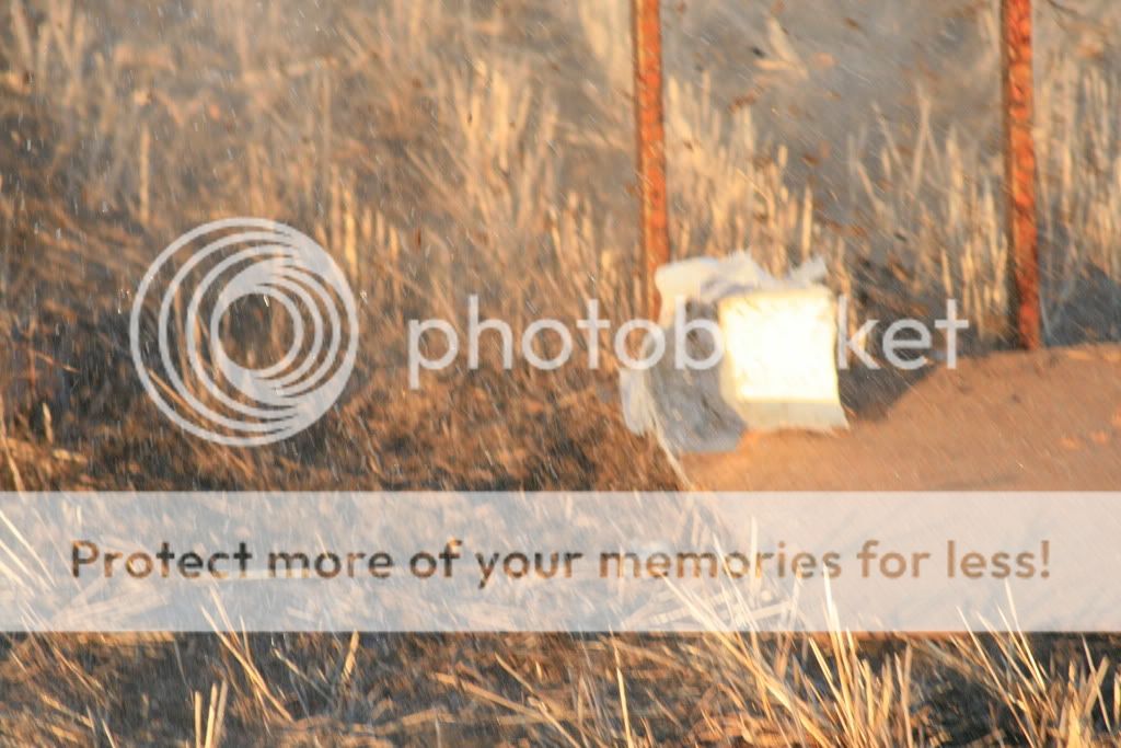

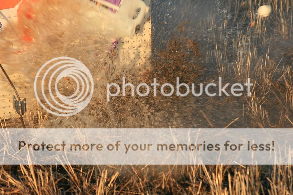

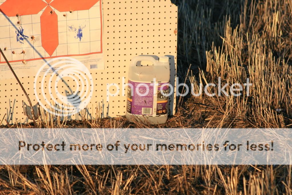

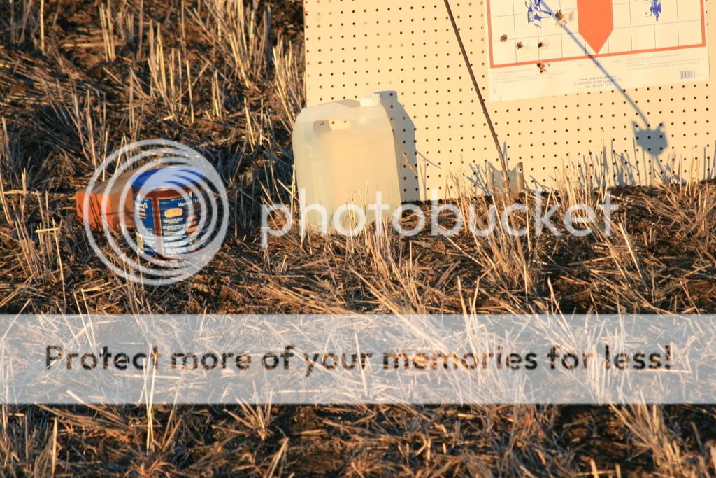

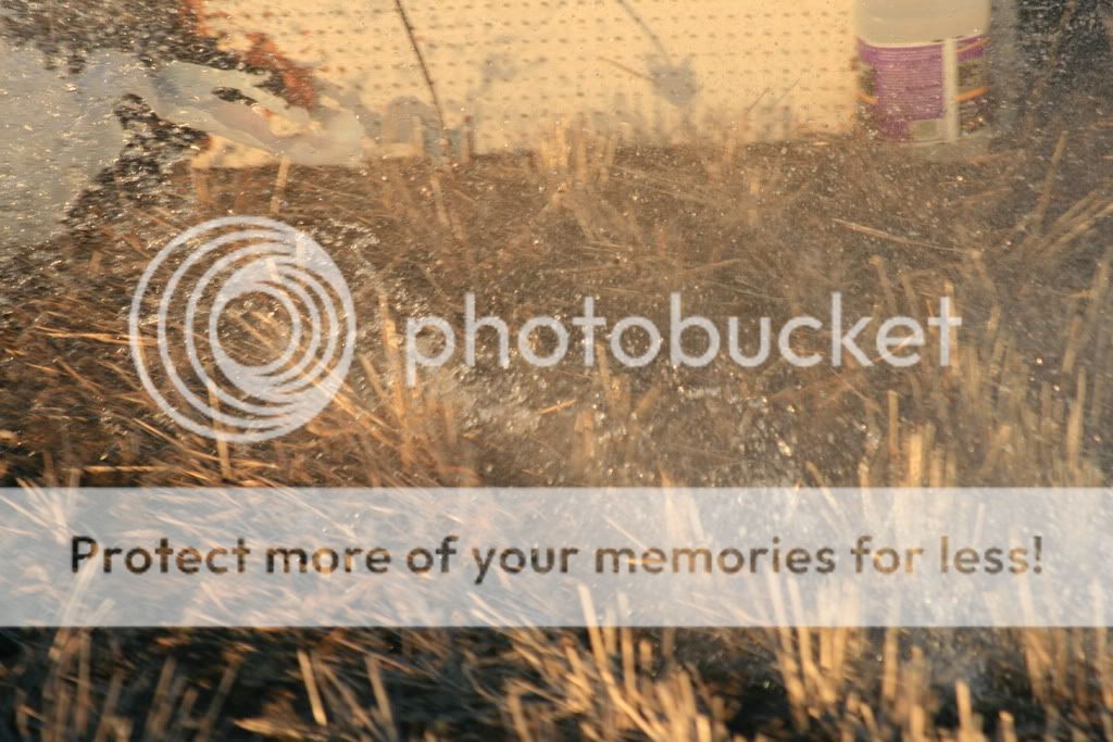

Took it down the road to do some blasting. Recoil was no worse than a 12g with slugs.
Now you see it
now you don't
I shot the 4x4 in the pic, bullet drilled right through with no expansion, the water jugs didn't fare so well, can't wait to try it on gophers, I actually bought it to replace my 17hmr;) kudos to the wife on some good pics.

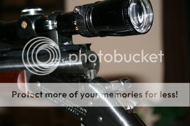

I got mine a month or so ago from Epps. Where did you get the hammer spur?
So far, I haven't had much luck working up a load, though I somewhat suspect that my ScopeChief VI 1.5-4.5 might be packing it in.
The recoil isn't bad at all. The pad and stock design is very effective at controlling the recoil of an ounce slug at 2000 fps. Like the 375 H&H, the recoil is more like a push than a kick, and I found the gun quite comfortable while working up loads from the bench

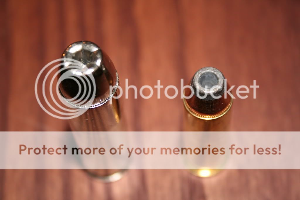

I was shooting Winchester Platinum 400gr hollow points factory stuff. I have shot a lot of slugs, IMO the recoil is comparable, the factory stock is quite good, very little muzzle jump, was worried about the swivel stud in the forend but it wasn't a problem.
Overall impression is a quite controllable short range big bore thats fun to shoot for under $300, only down side is factory ammo runs $55/box/20 but I reload and am planning to get into bullet casting.
