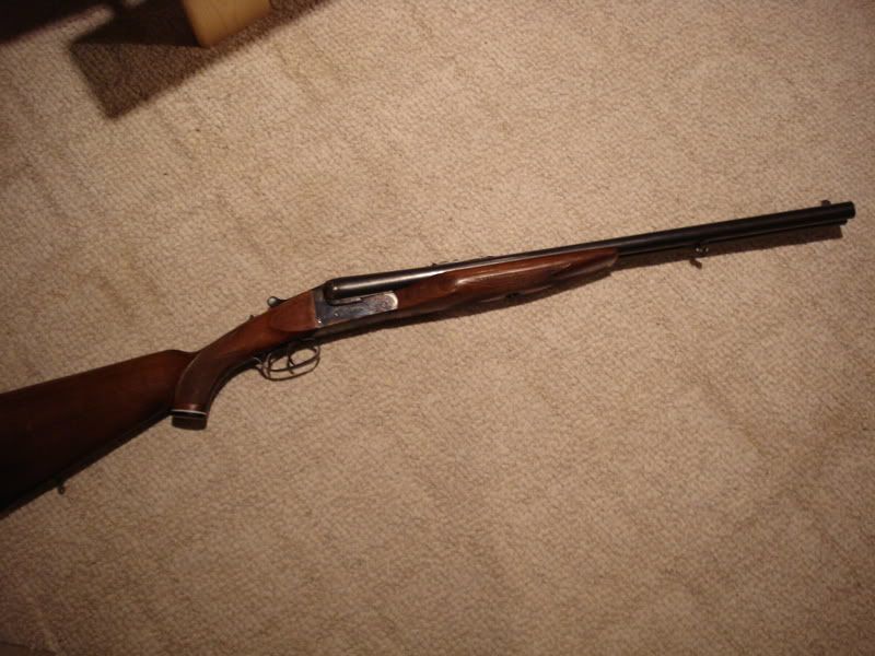

Here's my slug gun, a Lanber Supreme with 3" chambers. She has express sights, and barrels cut to 24". She's very much a "modern" gun:

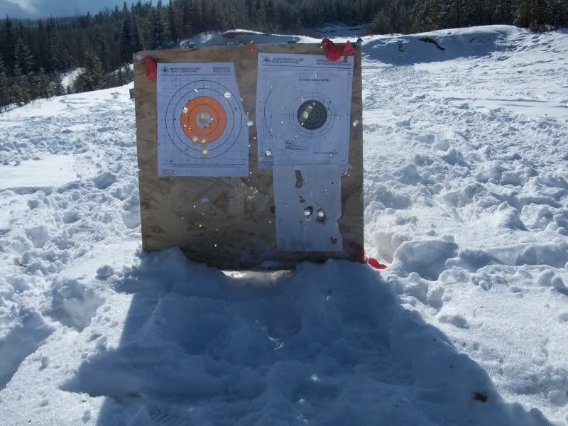

This was 35 yards:
Guess which holes are mine:

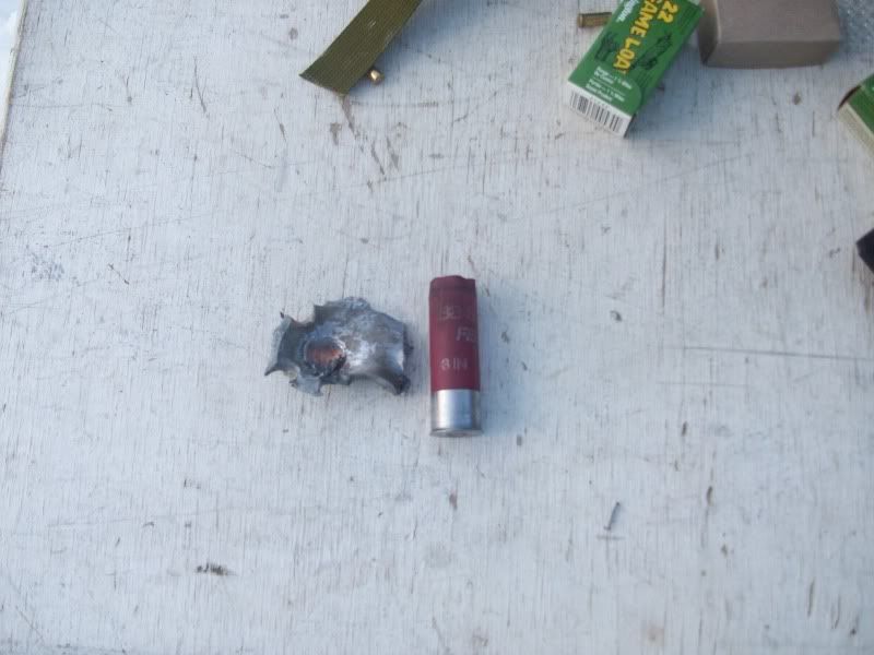

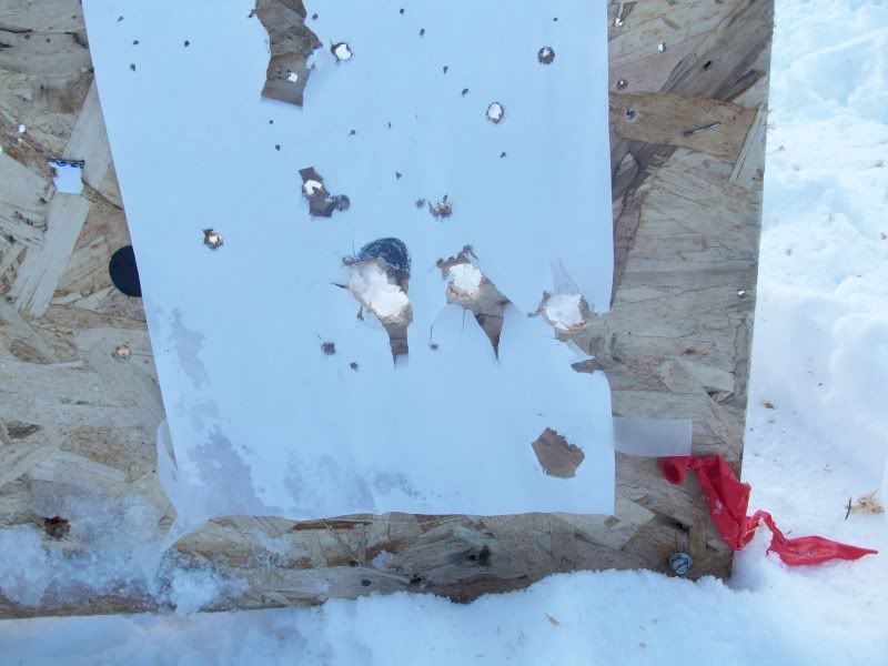

As a "penetration test" on the day, I shot my slugs at a 1/2 steel plate. This happened EVERY time I pulled the trigger:

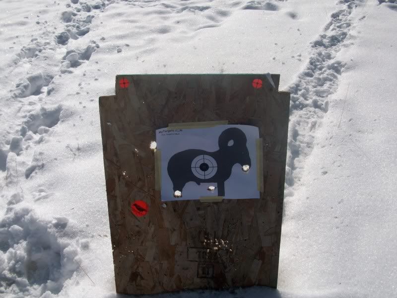

Ten Yards (the ones on the left were test rounds):
Test target @ Ten Yards. 4 Rounds. The ones on the left are left barrel, ones on the right, right barrel. I actually used proper aiming procedures this time instead of just banging away:

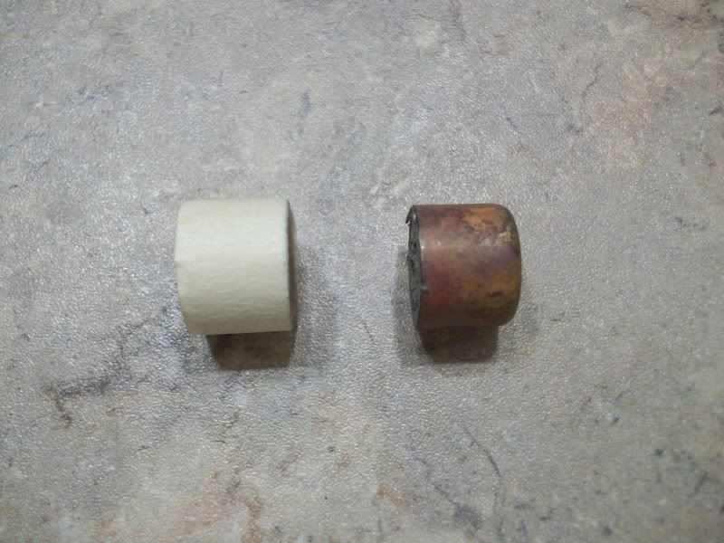

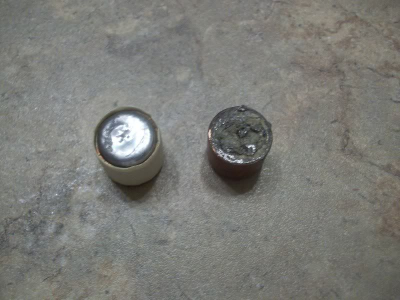

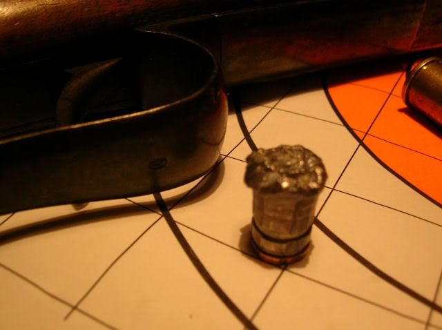

Here are some pics of the slugs, wrapped and unwrapped (the one on the right is a reject, as you can probably tell from the base):

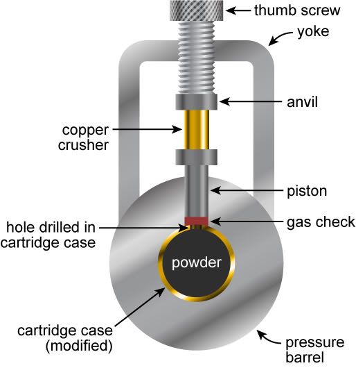

Here's a diagram of how a CUP testing device works. Figure maybe it will shed light on my above written descriptions:
