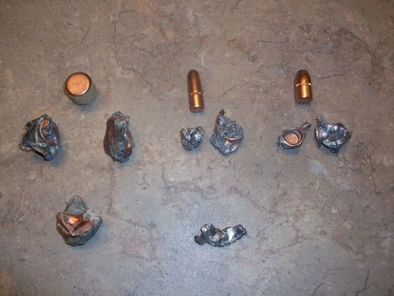

Made it out to the range today to do some more testing on the slugs. Shot a few paper targets, but also did some penetration testing on hard-pack consisting of old Outdoor Life and Field & Stream magazines.
For this test, I used 3 rifles: a 45-70, my 375 Taylor, and my SxS slug gun. Approximate velocities of each (as I still don't have a chronograph) are 1800fps, 2450fps, and 1400fps. Distance to target was about 10 yards, and test medium was dry magazines.
Results
Penetration:
.729 cal 580 grain slug @ 1400fps = 3 3/4"
.458 cal 350gr Hornady FN @ 1800fps = 4 3/16"
.375 cal 300gr Hornady RN @ 2450fps = 5 3/16"
Weight Retention
580gr Slug @ 1400fps = (shot #1) 492gr (shot #2) 564gr
.458 350gr @ 1800fps = (shot #1) 99gr (shot #2) 144gr
.375 300gr @ 2450fps = (shot #1) 81gr (shot #2) 231gr
So the above are the results. Interesting thing is that the slugs penetrated almost as deeply as the 45-70, yet retained weight much better, AND caused a "wound trail" that was the size of a small fist. The 375 penetrated the deepest, and also made a very large wound trail. The 45-70 shed its jacket both times, and caused a wound trail that looked like a mouse chewed its way through the hole. Lots of little bits of paper compared to the other two.
(Top left: slugs, middle: 375, right: 45-70. Bottom Left: Slug recovered at 50 yards in dirt backdrop (Weight Rentention = 568gr), Bottom right = .54cal Muzzleloader round ball)

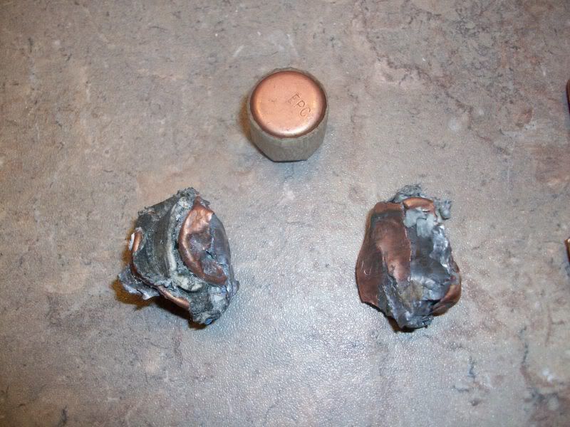

Close-up of slugs
Actually I was pretty surprised as to the penetration, as I had hard-pack stacked close to 36" deep, and the bullets only penetrated a max of 5" or so.
The funny thing was that I had the bundles wrapped in duct tape to keep them together, and as soon as that first slug impacted, it wound up splitting the duct tape.
Next time out I'll try a wet-pack test, and maybe try and blow up a few milk jugs as well.
