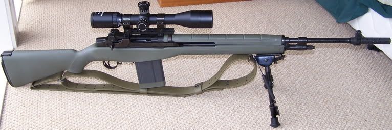

Here is what I did;
Pietro
I can tell ya what I did. I used a dremmel (sp?) to cut a nice clean line on the plate which is used to attach the sling that is already mounted on your stock. I then drilled out the rivet closest to the mag well. I used a sling swivel stud and ground them down so there was only about a couple of mm of clearance. I then installed the stud with a washer and some of that lock tight stuff and made sure the clearance was good. Took about ten minutes and hasn’t cracked the stock or nothing. I carry this rifle almost every day hiking around and no problems. I then attached the quick release Uncle Mikes Sling gizmo to the bipod. It’s quick and real easy.
