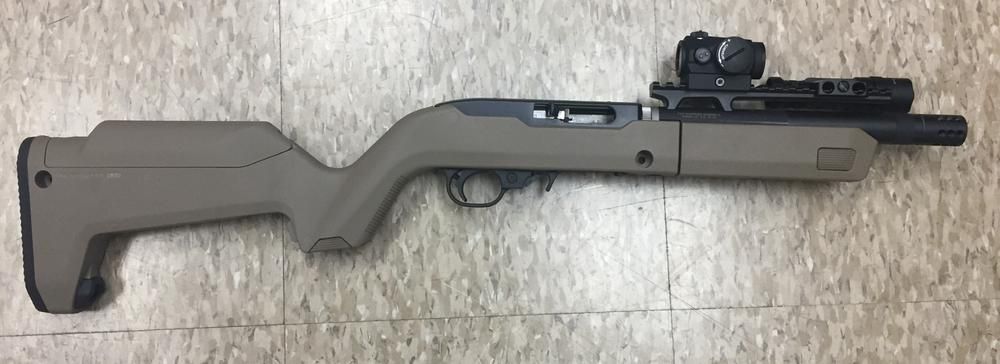

Here's one the Calgary Shooting Centre built. I'm thinking of doing a similar project. My big question is should you stick with the factory 16" or go with the charger barrel. I was wondering if anyone has chrono it? What's the difference in velocity? How much bullet drop vs. stock barrel out to 100m? Is it even worth will putting the charger barrel on?
They are not "Charger" barrels... they are just short barrels... as long as the OAL is 26" plus the gun will be NR, assuming that you start with an NR receiver. If you start with a restricted Charger receiver, no matter what barrel you put on it, it will remain restricted.
The Adaptive Tactical barrel shown in the first post is actually called a "Charger" barrel by AT. From their website: "TAC-HAMMER RUGER® 22® CHARGER TAKEDOWN BARREL/RAIL COMBO". I believe they call them a Charger barrel since in the US you would only be allowed to install this barrel on a Charger pistol, unless you went through the legal process to create an SBR. Luckily we don't have those regulations in Canada.

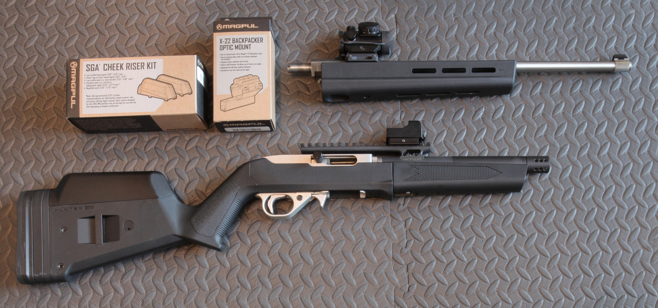

As to the question: "...should you stick with the factory 16" or go with the charger barrel" - in my case the answer is do both! I really don't need a takedown 10/22, but I like having a modular rifle that can accept multiple different barrels.

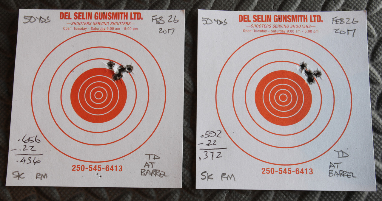

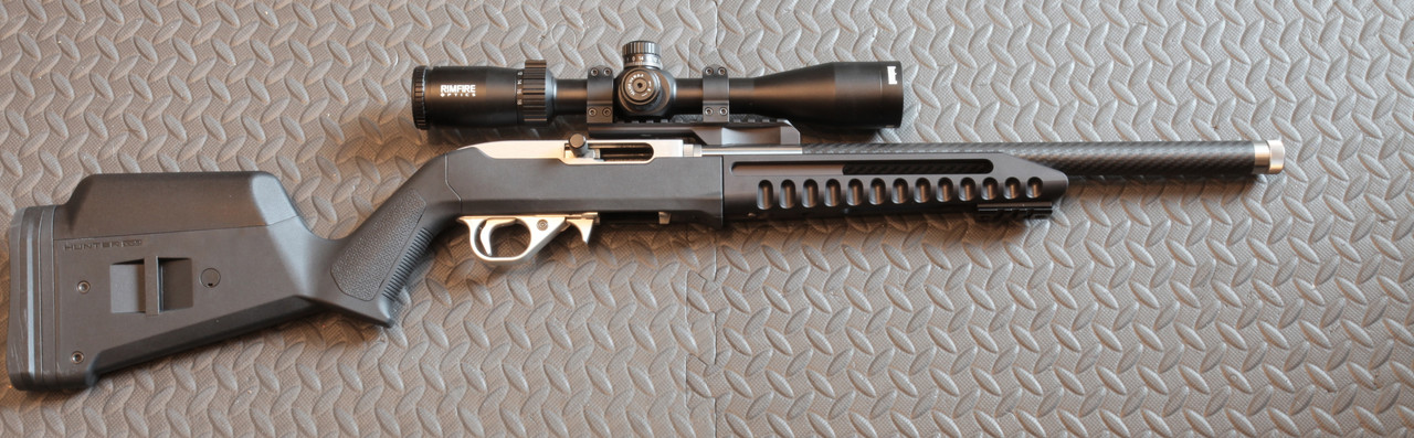

I highly recommend the AT Charger barrel, I found it to be remarkably accurate, more so than the 16" AT version which I sold. I prefer the 16" Volquartsen to the 16" AT, shown in the bottom photo (better accuracy then the 16" AT and a better rail design).
I can't address the questions regarding velocity and 100m accuracy as the vast majority of my shooting is at 50m. Here are a couple of groups shot with the AT Charger barrel at 50 yards (using a Simmons 3-9 scope, not the red dot shown in the picture above):
I didn't think about that. I wonder if MAGPUL sells the forends separately? That would be the way to go. Have a bunch of forends and barrels, makes it a versatile rifle.

One of the reasons I have come to really love the Ruger 10/22 Takedown is,as already mentioned,its versatility. I consider my T/D a "switch barrel" and I keep a 16" Stainless threaded factory barrel with Skinner sights ready to grab at any time. If myself and my family were in a situation where we had to be armed my wife would carry the rifle in the configuration pictured below. With the front a rear sights both barrel mounted zero is spot-on everytime. I know Tom.E.Gun and others think along the same lines and run multiple configurations and therein lies the beauty of this rifle.
