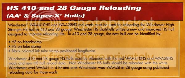

I have been reloading 410 for a couple of weeks now and still have a problems with the load. I have a browning 625 which had a trigger job to fire 410. It works great with factory ammo. But not so good with my 410 reloads. I started with mec # 11 bushing in a 600 junior. I'm running now a 12 and they are still too light. I measured my shot and it's .5 oz. I measured the powder and it's dropping 12.2 grains. The recipe calls for 12 in an aa hull with Winchester wad and primer. I noticed that the shot is sitting to low in the hall before the crimp. I was wondering if anyone has ran into this problem? Has anyone used a 12a or 13 bushing? Will the pressures be safe?
