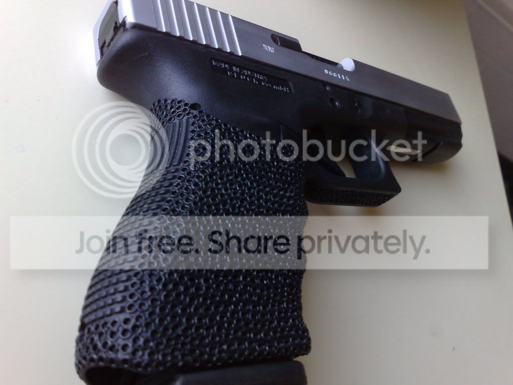

For a fun little project I heat stippled the grips on my personal hi-point. It was my first attempt at heat stippling but I'm quite pleased with the result. The grips are much "grippier" now.
I used a cheap canadian tire soldering iron. I replaced the tip with a brass screw. The screw was a round head slotted. I used a dremel to cut an additional slot in the screw. Then I used a small file to groove out the slots a bit.
I taped off everywhere my hand does not make contact. For the stippling, I just touched the hot screw onto the plastic for a second (or less). It melts the plastic and puts 4 little stipples. Repeat a million times. The actual stippling time was probably about half an hour. I then used a razer blade to shave down the peaks a bit. The net result is a very grippy surface.
While I was at it I also polished the beam on the slide and contoured the trigger guard.

I'm trying to figure out why your hand doesn't make contact with that portion of the grip on the left side????
Where my fingertips end? It'd be a pretty small grip if you could make contact 360* around it. My hand and fingers aint small, that's just where the contact ends.
