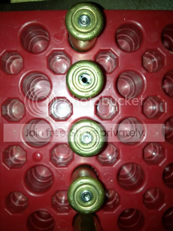

Back when I got my berthier carbine 8x50 Lebel, I converted some berdan primed brass...drilled a flash hole leaving the wall of the berdan primers crimped into the case to hold the new boxer primers...it worked on most of them.

It took me an hour to prep 5 cases. I drilled out the centre of the primer, and left the outside of it in the hole to shim it, it turned out to be perfect for seating a Large Rifle primer. In some cases where my work was sloppy, I didn't get a very good seal tho'.
It was MFS 7.62x54R.
Here's some 8x50 lebel berdan brass converted to boxer...just to show the central flash hole which makes it easier for "re-reloading" as you only have to drill once.

I did it very carefully with a vise, an electric drill, and lots of time !!
I don't remember which bit sizes or anything...that was a long time ago.
I would need to have some pretty rare cases to spend the time doing that again I think. But best of luck if you are planning on trying it, it was worthwhile for me at that time so that's all that mattered :)
