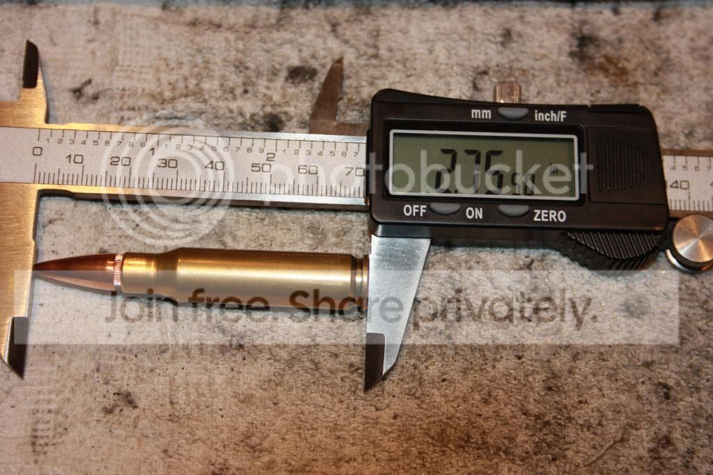

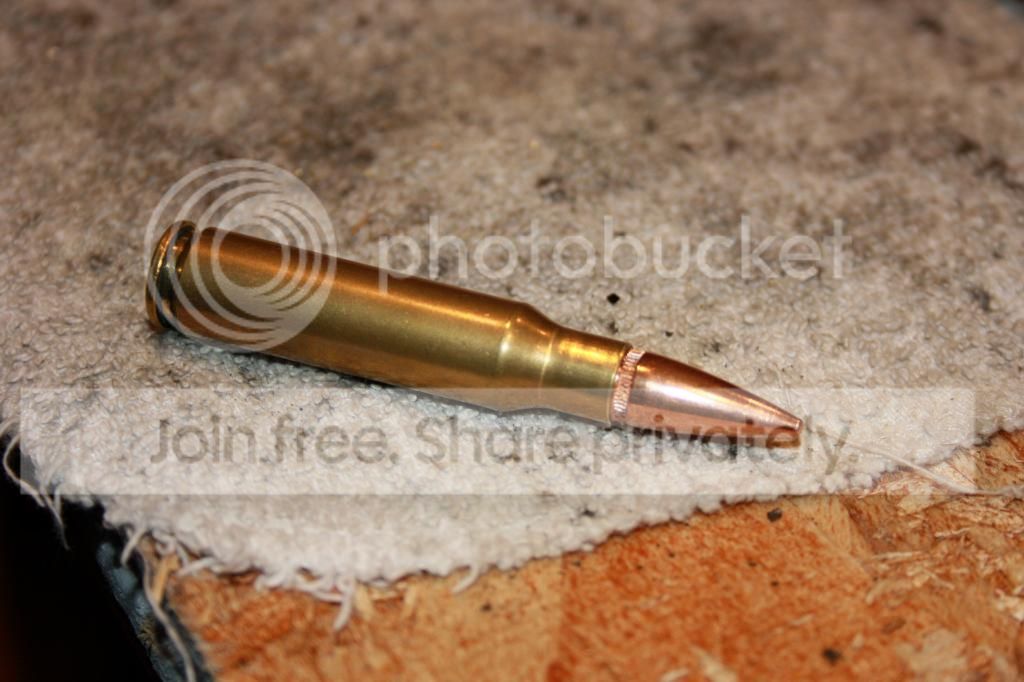

New to this so I thought I would ask the pros! I have been reloading Hornady 180 grain spbt for my 305. After a bit of reading I see that the projectiles were a tade heavy for the 305's gas system. So I picked up a box of Hornady 150 fmj and got started...... one round in, (following the Lee specs from my die set) when seating the 150 grain projectiles I can't get the case lip to engage the cannelure and there for not crimping the round. I didn't have this problem with the 180 grains projectiles, and got a nice crimp and finished product. Will these rounds be safe to shoot? Does the cannelures have to be engaged to the lip of the case? Will it affect accuracy? listed below is what I was using to load;

Adjust your seating stem to seat the bullet deeper then adjust the the die to crimp into the cannelure if you want to crimp. Sometimes you can't have both desired oal and crimp.

But if I seat the bullet deeper it would be under the min OAL?

I shoot 150 gr Hornady FMJ's over 47.0 grs of BLC-(2) seated at 2.800" in my M305, and my loaded rounds look much the same as yours. I don't though because I don't crimp, and I don't know why you do.
Pretend the cannelure isn't there. You don't need it, to crimp.
It won't affect accuracy or safety.

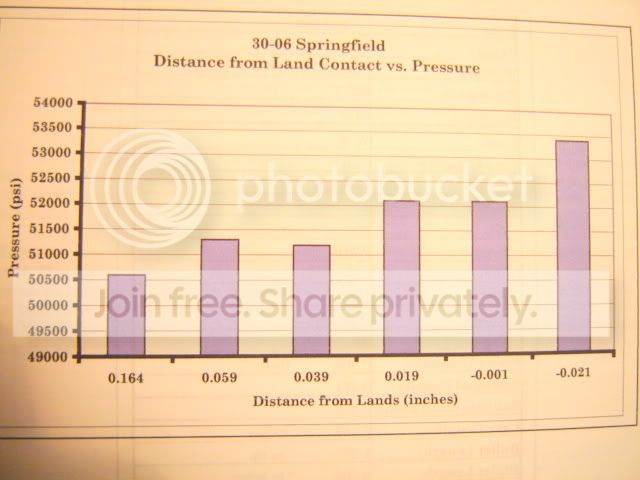

It's good to challenge these kinds of statements, particularly ones that talk about "blow ups" and have entered into reloading folklore. Very small capacity pistol cartridges shot in relatively weak pistol actions are one thing, but for rifles, there really is no Min OAL with respect to "safety". OAL does affect pressure, but in fact reducing OAL typically lowers pressure (except for when you're very close to the rifling) - case capacity might be reduced a couple of percent, but the bullet is given a longer "runup" to the rifling. I found this chart (and carefully chosen Interweb charts always prove someone's point! ;)) that shows the effect of varying OAL in one 30-06:
I do have to respect mag lengths, and for lever guns the correct length that allows for reliable cycling, but with all of my guns, I load to the OAL that provides the best accuracy and that's usually about 0.020" from the rifling.
