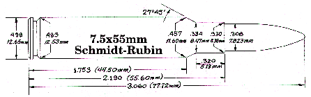

Found a few of these cases at my range.
From what I could research it was made by Dominion Arms (Quebec) in 79 Berdan Primed but I looked through my reloading manual and I couldn’t find what cartridge this is.
Measurements are approximate.
Base- .495
Coal- 2.178
Length to shoulder 1.760
Case mouth inside is .305
Case mouth outside is .341
Would like to add it to my collection but need to identify it.
Thanks

I just looked up the measurements for the 8mm Mauser book states it has a .473 base while mine measure .495. COAL is 2.244 while mine is 2.178. To me those are significant differences. Even to the shoulder the difference is .059.

Left side: D= Dornach, brass supplier
Right side: A = Altdorf, ammo factory
Top: 7 = month of manufacture
Bottom: 79 = year
