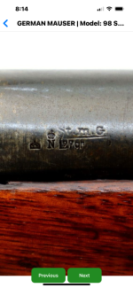

Hey everyone , I picked up this Mauser 98 from an auction. Curious if anyone can give me some info about it based on the markings and photos. Anyone know what I should order to mount a scope on it? Is there much thing as small 2 piece universal rails? I have a gunsmith that told me to figure out what I need for it and he’d drill and tap it for me…seems lazy but whatever. It is chambered in 30-06.

French proof marks, military action( has thumb cut out in left side rail for clip loading). Nice sporting stock. Guessing made between ww1 and ww2 in France.
