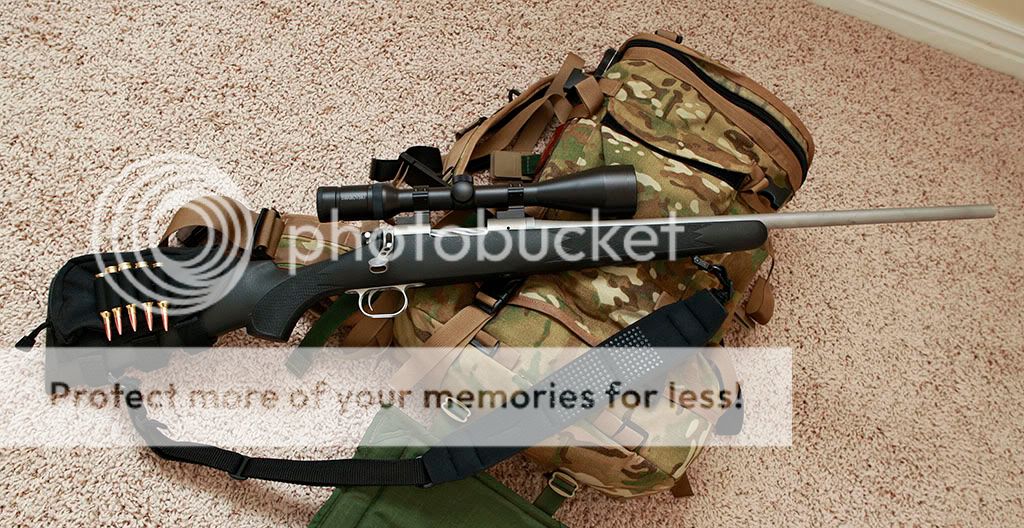

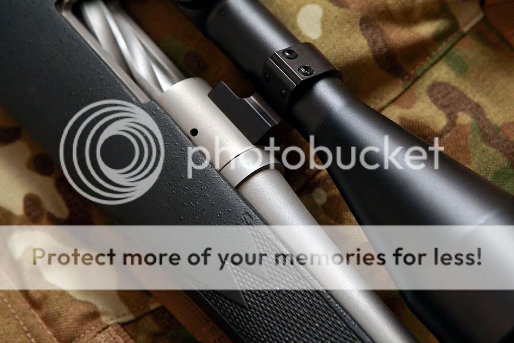

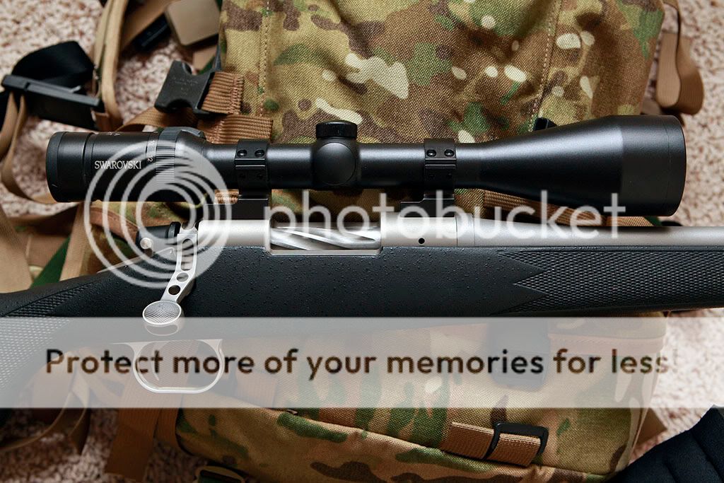

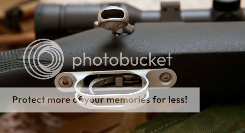

This rifle is ULTRALIGHT. 7wsm, Rem Titanium short action, McM Edge Tech carbon fiber mtn. stock, and Lilja light contour 20" barrel. We added a Jewel trigger, titanium firing pin with lightweight aluminum bolt shroud and skeletonized the bolt handle and trigger guard. Weighs in at 4lbs, 10oz.
