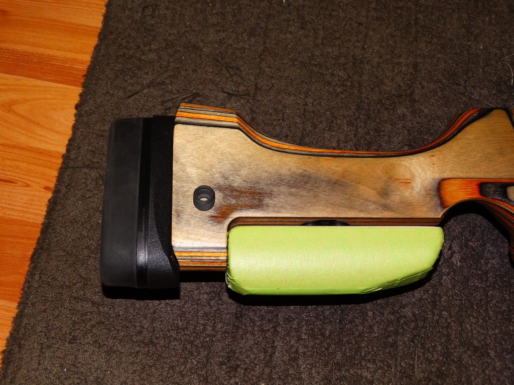

The first big problem is the stock being pretty well right hand only. I've already made a new cheek rest that is symmetrical on both sides. (the factory one favors a right hand shooter.)

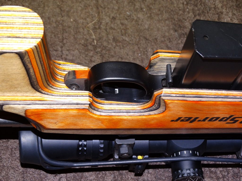

Next I have to make room for my trigger finger on the left side. I think I will open up a finger grove on the left side similar to how they did it on the right side.

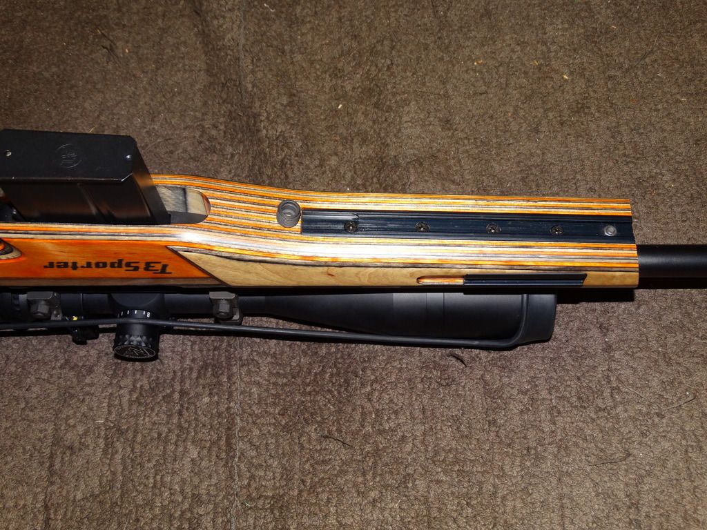

I also want to open up the magwell similar to how the TRG is. Currently I can't easily get to the mag release.
My last question for now is where to add sling QD's? I bought a Rifles Only FTW sling and got the QD attachments.

Heres some pics of how it sits now.

I don't think thinning out the left side trigger finger area will weaken the stock. Its also pretty safe to say opening up the the stock to get to the mag release would be ok as well.
I'm not an expert though. So there is only one way to find out. :)

Here is a better pic of the area where I want to remove some material for my trigger finger and to get to the mag release.
Is this to far back for the flush cup under the forend?
How does this flush cup position look for the butt? Should I put one on both sides?
Thanks.
