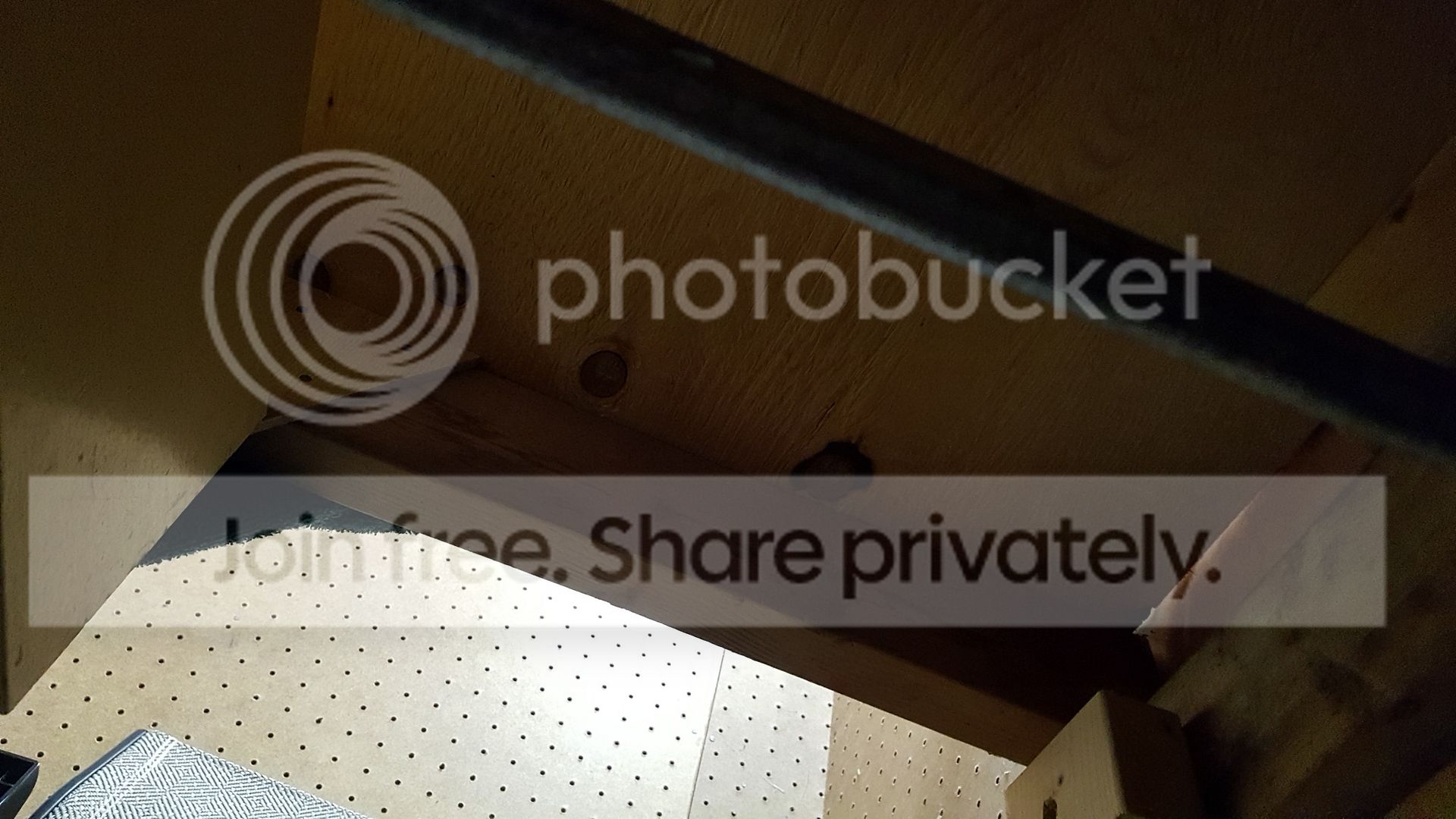

Do those go on the bottom side of the bench? I really like that idea so I won't have the plate in the way, or have to worry about having to put it off to the side.
Just measured the bench, exactly 2x8, so buying one sheet of 4x8 plywood will do both layers perfectly.
Yep, they go in from below. Setting them is done with just the regular bolt and a ratchet to pull them into place. Use a scrap to prevent the washer on the head of the bolt pulling down a divot in your nice clean top.
I likely went a bit OCD on the whole thing and added a little PL Premium to the flanges when I set them.
The mounting plates also use the T nuts set into a recess done with a Forstner bit. I could have set the heads of the bolts in from below in a counterbore but that would have left less wood. The T nuts only require about a 1/16 inch depression so there's more wood left. This means that some hacksawing and filing of the bolts is needed to cut them to the proper length. Or I could have used more washers. But after seeing the pictures of the work area you can see why I cut the bolts instead of going ghetto with washers.... :d

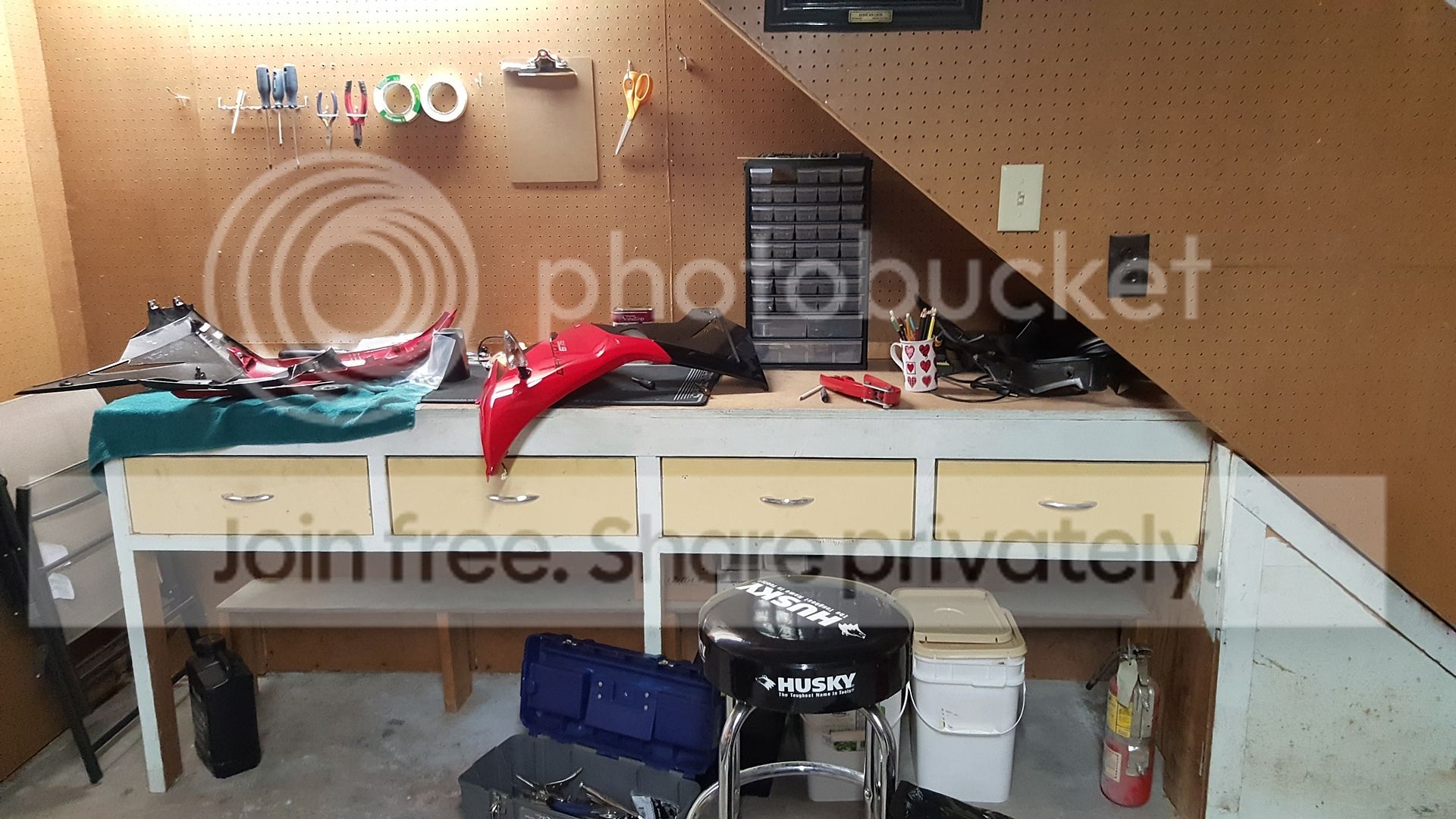

Okay, got the workbench top on and it's pretty damn solid. I couldn't put the cross braces across the depth due to the drawers, would have rubbed on the top of them, I did however brace the rear of the bench as there was no support there.
My next question is about securing it to the floor. How necessary is this? I'm not doing magnum rifle cartridges or anything, I'll just be doing .223 and pistol calibers. I do notice if I grab the workbench from the bottom and lift up the legs will come off the floor, takes a bit of force though. The only operation I can think of that will move the bench in that direction is priming, which shouldn't put that much force unless I forget to swage a case.
In the event it is necessary, a friend of mine has offered to lend me a hammer drill. How would I go about securing a vertical 2x4 that are the legs of my bench? With a right angle bracket? And what kind of anchors would I use?

Well, I say a stud but it's actually 4, and that's just with the cross braces I put at the rear of the bench, I believe the existing structure that is there is secured as well to the studs.
Basically my test was to get on top of the bench with my body then jump on it. Couldn't feel it moving anywhere.
Also I forgot to mention I screwed the first layer of plywood down, then screwed the second layer from the bottom with 1 1/4" screws. Haven't drilled the grid for the tee nuts yet, plan on doing that when I get the press and can measure/plan a bit more carefully. I'm thinking a 2x4 grid of them spaced 6" apart should do the trick, but again I'm waiting on the press to really get a sense of how it's all going to come together. Figured I'd mount the press to a 2x8, if that gives me enough room on either side for securing the press.

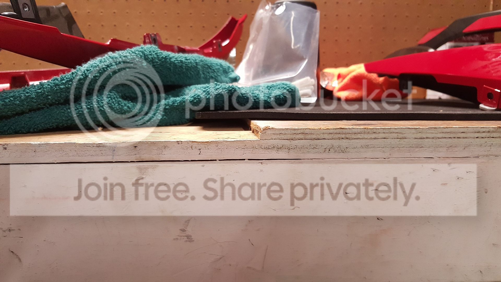

Also, the top layer couldn't be recessed back like the first layer, so I had a bit of overhang, so my buddy suggested I run a skill saw along the edge to flush cut it, bad idea, haha. I ended up gouging and screwing up the front of my bench in a couple spots. Just ended up slapping some wood filler in there and doesn't look too bad. I figure I can give the face of it a coat of paint to hide my shame.
Get a piece of hardwood strip flooring or similar hardwood and glue & screw it to the edge that you chewed up a bit, it will provide a nice durable finished edge, the plywood edge will chip and get chewed up over time if it is not protected.
