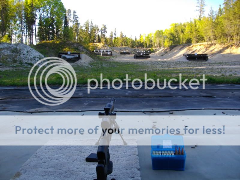

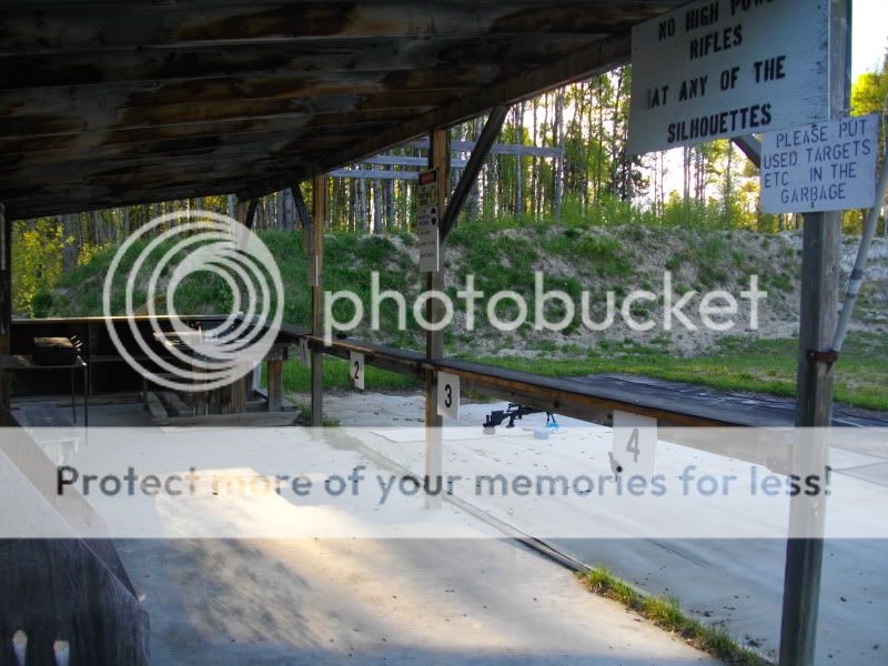

I added some pics of the range I am using, maybe it will show what I mean about not being "square" to the target, but i'm sure at this range it is not going to make much of a difference. Anyway, on to the pics...

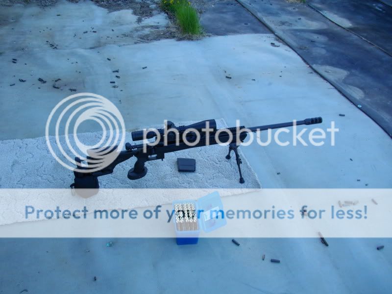

This is my new postion, more "square" to the target.
This was my original shooting position, you can see the 100yd berm on the left
Yup, looks like things are going much better now. Keep shooting and get her dialed in to the yardage you want to shoot at.
