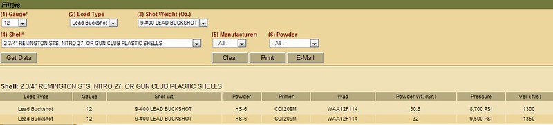

Looking at the load data from Hogdon website, I can get everything minus the primers which calls for CCI 209M but I am only have available right now is Federal 209A, Am i safely able to use federal instead?
Here's the load data, I will be doing the lighter top one as this is my first time reloading buckshot. Also will be using Claybuster wadds CB1114-12 which is the equivalent.

Primer substitutions aren't recommended when loading shotshells, especially substituting a hotter primer like the Federal 209A.
The load Hodgdon lists will work in theory but actually will cause the casing to bulge pretty badly; sometimes, they won't even chamber.
You'll need buckshot pellets .32" or smaller diameter if you want them to stack nicely in the shotcup.
Also, the claybusters equivalent for the WAA12F114 is a clone of the 2nd version of the winchester wad.
The original WAA12F114 had a much shorter cushion section and allows for a better crimp; downrange manufacturing makes a copy.

Being in hamilton, go over by the ancaster fairgrounds, there is a place called hummasons, they have cheddite primers that work close with winchester primers, $35 a 1000, always have a ton of it in stock, best to call them first, they also supply powder and lead, Id use thosem and with then id work my way up from 30 grains of powder. There is plenty of room for the 11500psi reccommended max psi.CCi209M is fairly hot, and id use them as comparable with the cheddites.

load I use from Hodgdon site:
9 #00 buckshot
win 209 primer
WAA12F114 Hull
HS-6 30gr
1250 fps

From the lyman manual:
12ga 2 3/4
HS-6 31.5gr
fed 209A primer
*then under wad column, it says:
one B.P. BPGS
one 12ga 1/2" fiber under pellets
one 12ga 1/4" fiber under pellets
Use 9 pellets of 00buck
hope this helps
