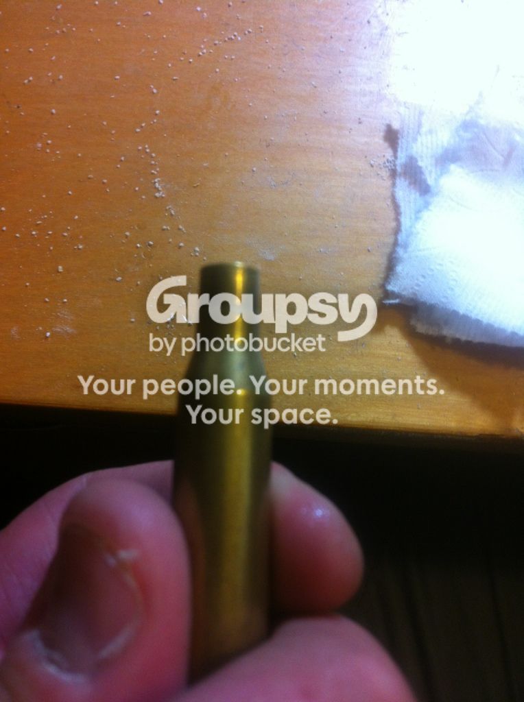

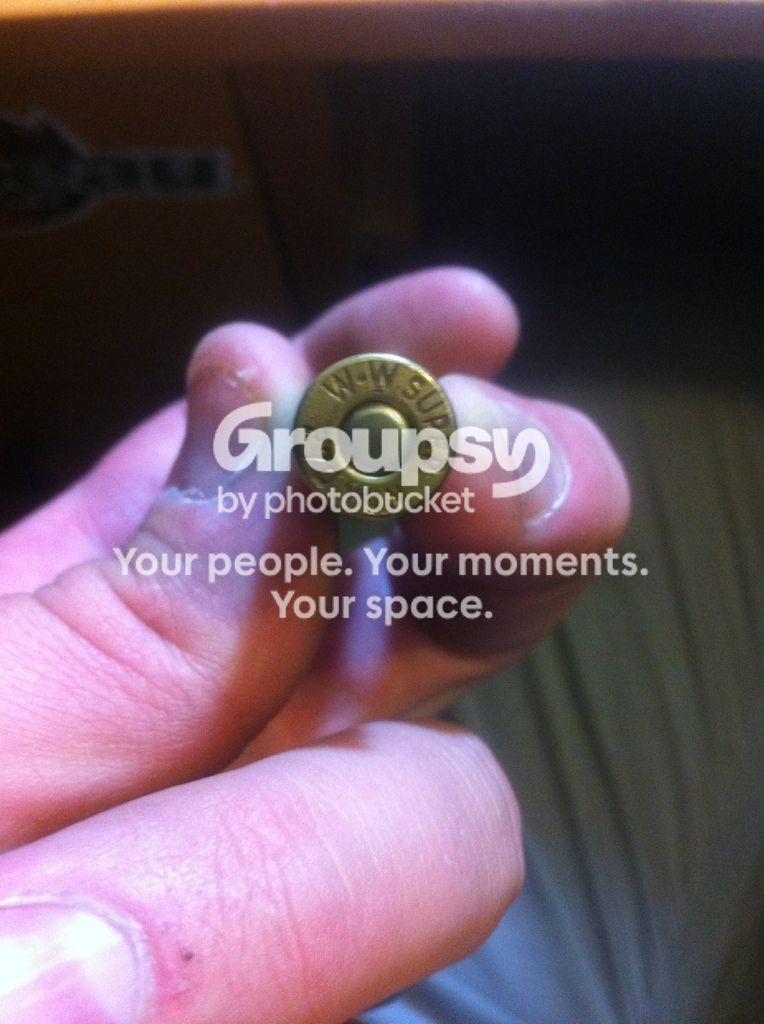

270 Brass I started with
Using the full length resizer, I resized just until it fit into the rifle and closed the bolt. About half of the neck got resized.

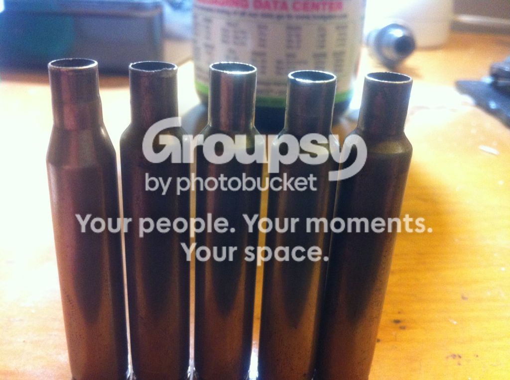

Here you can see what 5 grains does on the left, and working my way up slowly to 17 grains, these are some of the many I used to work my way up.
