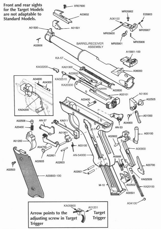

It has been many years since I had a mark 2 but if memory serves there is a small actuating arm inside the grip that needs to be in place for it to work right . I remember almost needing three hands and flipping the gun upside down to get the thing to engage . But that is where my usefull memory ends .It is a common issue and easily fixed if it is the same thing .
I think it is a01000 in this diagram.
this covers each step in writing and fairly good detail. http://www.1bad69.com/ruger/field_strip.htm
My bet would be one of 3 things.
First, when you put the back strap in you need to tip the barrel up just a touch to get the hammer strut to rest back on the mainspring ( part number A00100 above ).
Check that the mainspring plunger isn't jammed down ( pn-KA02509 above. ) this is wildly unlikely tbh but check anyway.
Nest would be to check the trigger return spring and plunger ( pn-A20400 & A02508 ) and the sear spring A03100.
If you didn't do a full strip down to the frame I'm doubtful much could have gone wrong. I'm betting it's just the hammer strut isn't contacting the mainspring properly.

Thanks for the diagram, it might help me to go over everything. I know the actuating lever inside the handle needs to be down and resting into the the other "pin assembly part", and at first I thought this was the problem, but I know I am putting it in properly now so that it is engaged insided the handle. I was wondering though, if maybe it is not resting properly which is why after one pull of the trigger it clicks and works, but then the second time I pull the trigger, I get nothing but a spongy trigger and no click.

for my Mark III I always make a full disassemble for cleaning after each session, you need to figure it out when insert the magazine and push way back the Inside the upper plate (piece A01800) and remove the magazine, then align A01000 at the good place, the back strap (A00900) must be in tension in the last 1/8 inch if not your not correct with your assembly.
make a full disassemble and reassemble.
