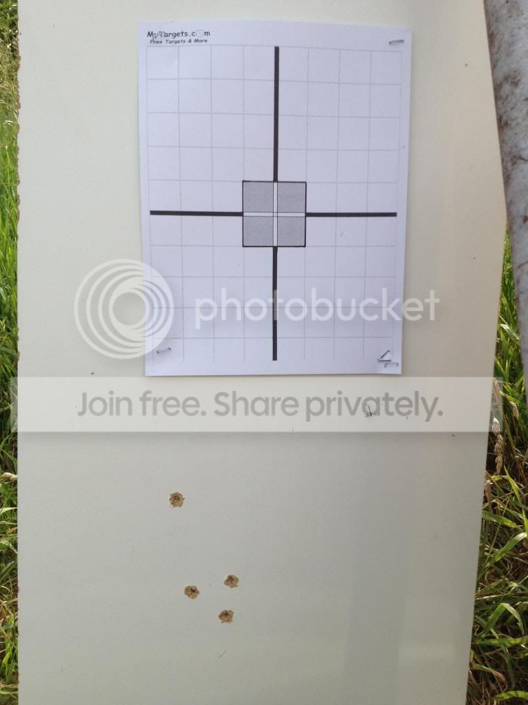

I have 12 targets like the first one. Worked up through 6 grains of powder and all target have 4-6" of vertical stringing. POI between 4 and 6" high of center.

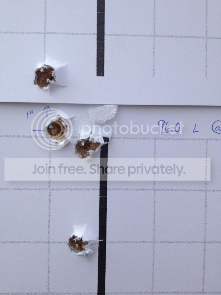

The result......My POI lowered about 18"! and I have a circular group( I pulled the one out). 200 yard group.

Is the first photo at 100 yards, or at 200 yards like the second photo?
In the first photo, I see four shots, forming a group 0.8" wide by about 2.7" high (assuming those are 1" squares). I don't see 4-6" of stringing. Do you mean that this group is 4-6" above your point of aim?
In your second photo, I see a larger 4-shot group (perhaps 2" wide by 4" high), that looks to be 10"-12" below what I would guess you were using as our point of aim?

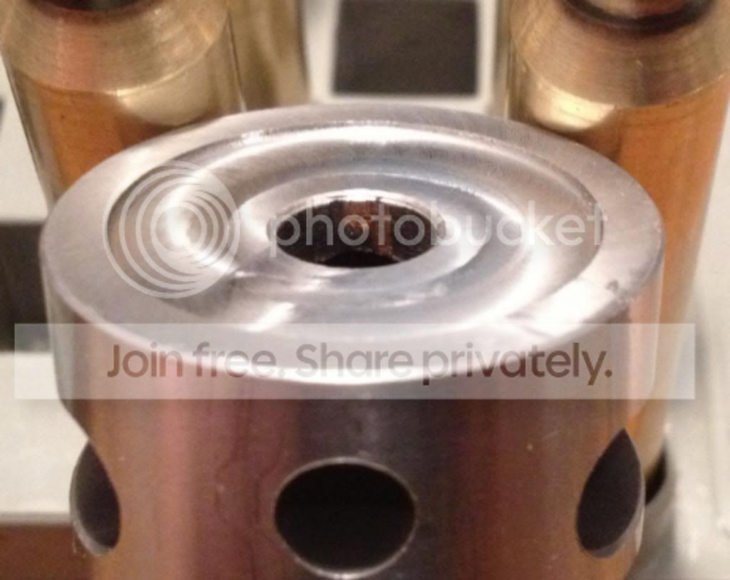

Have a look at your muzzle brake. Is it possible it was on crooked, and the bullets might have been touching one of the baffles on the way out? Are they equally dirty, or is there a cleaner/less-fouled/scuffed/brighter spot in there?

First one is 200 yards also. My targets are 1" squares.
The vertical string target I posted has the least vert. So between 3-6. All are under 1" hor.
I have checked the brake multiple times, no sign of any strikes.

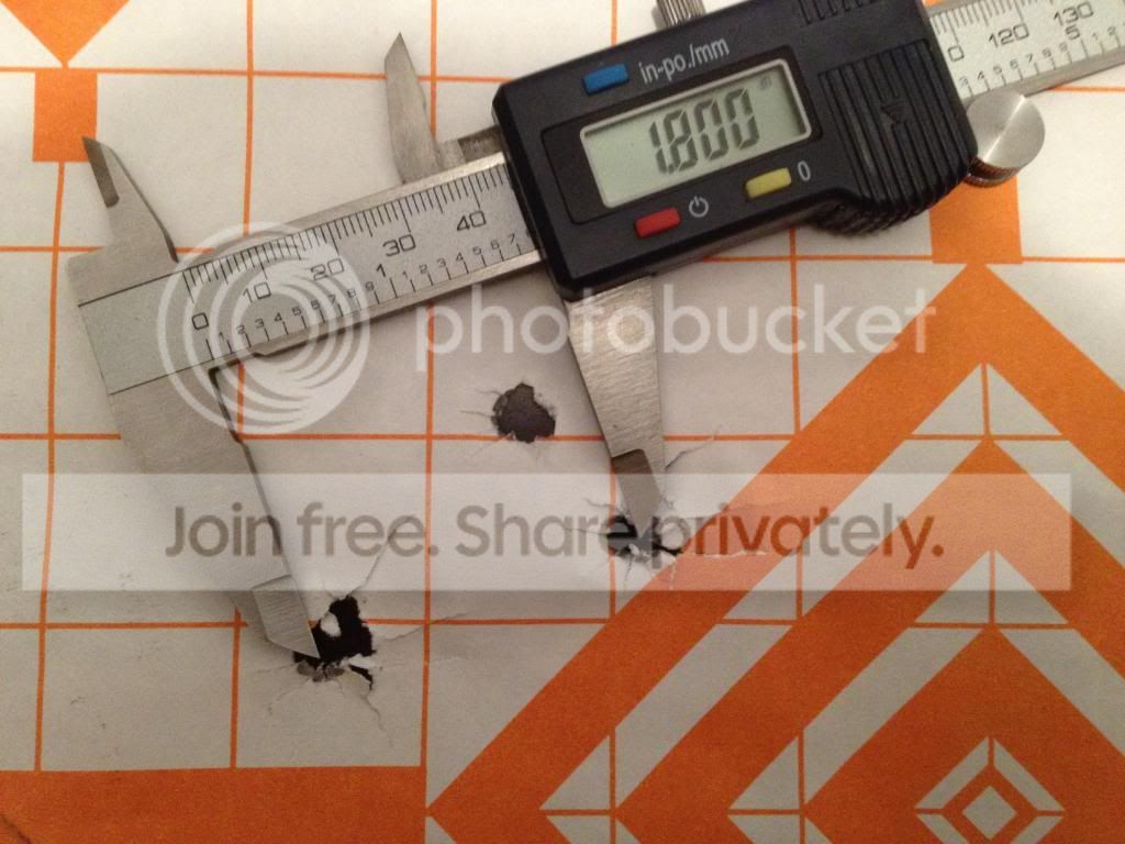

So I made it out tonight for a couple more shots. I re-installed the brake and fired 4 rounds. No point in posting the picture as this happened. Needless to say I am a little pissy with the gunsmith that installed it.
This was the group without the brake @ 200 yards
At least I know what the problem is now.
Problem solved and I have a happy shoulder!
When the smith turned the shoulder into my barrel, he went .002 too far in. The brake was timed at 1 o'clock so he used a set screw in the bottom of the brake to hold straight up. The screw was tilting the brake very slightly. I cut up a shim so the two shoulders would lock up. Voilà.... 1.1 MOA on a starting load.
