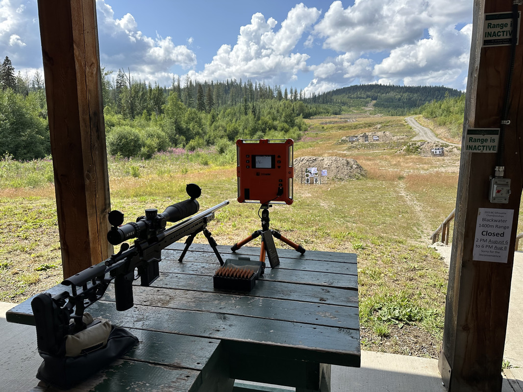

I mostly use my MDT GrndPod, combined with a basic leather/vinyl bunny ears rear bag. I load up the bipod a bit and get the height/position on target by squeezing the rear bag with my left hand. Then, with no directional force from my strong (right) hand, just focus on a smooth trigger pull. I also keep my strong hand thumb on the right side of the grip. I don’t wrap my thumb around the grip.
First time I tried shooting 1k and beyond was effortless this way.
Hey Jim, id like to go to Blackwater, has it been typically busy when you were there? Wondering how long a cease fire would be?
It’s a great facility. Longest ceasefire was about 15 minutes as a guy drove out to grab his stuff from multiple distances. I’ve only been there a couple times, and it wasn’t busy. The people that were there were great. Super friendly and we had a great time.
