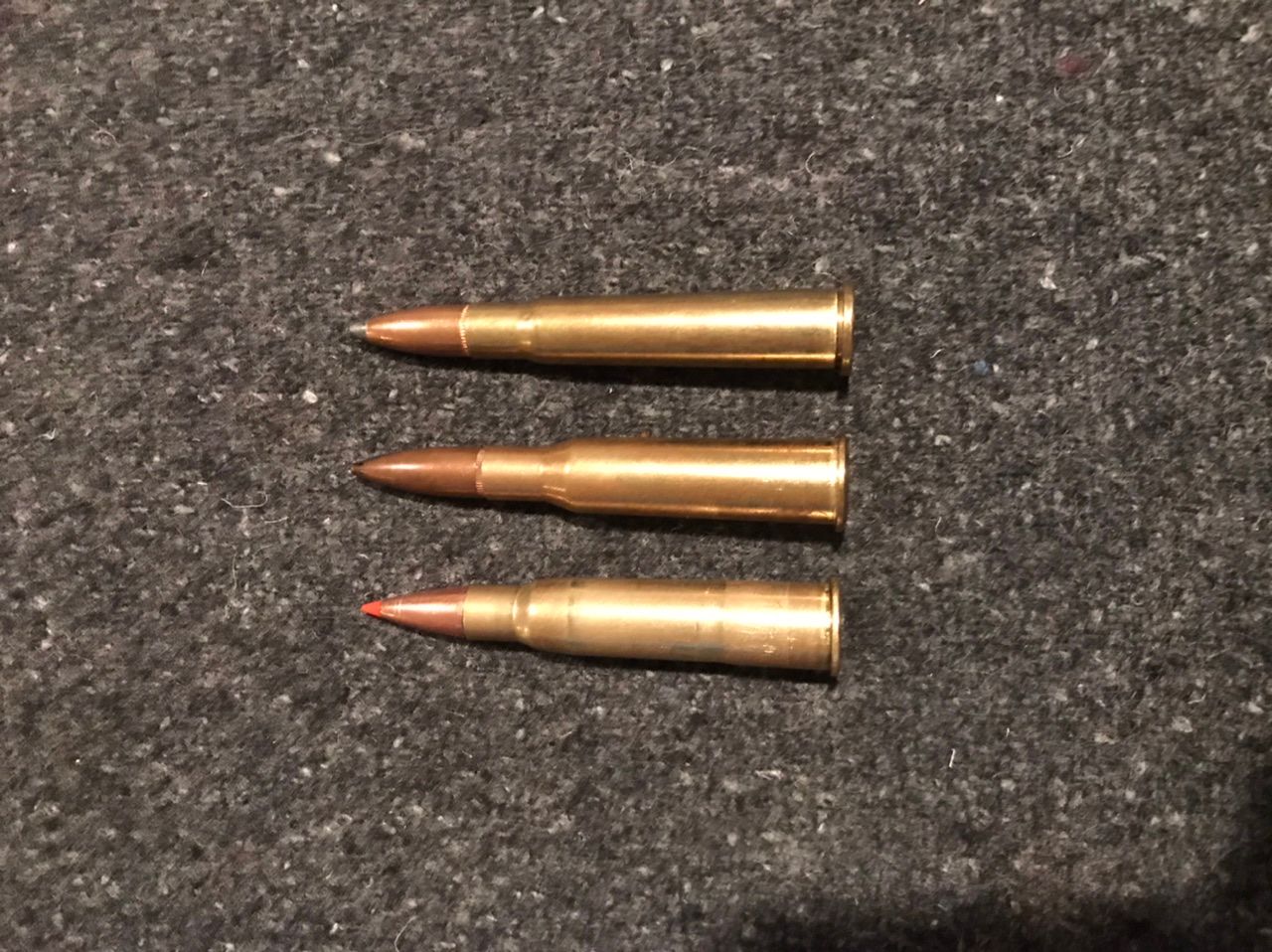

7.62x55r would likely be very similar. If the bullet was based of 7.62x54r it is basically a 7.7 by our measurements.
A .303 in metric is 7.7x56r main difference would potentially be case head size
Ok so I fireformed the 303 Brit with a very very light load. It isn’t chambered in 303 Brit. The body of the case is too narrow. The 7.62x54r case is better but too short. After looking through my books I think the best thing to do is is start with an 8x56r case, fireform to set the shoulder forward and neck resize. Thoughts?
It should work, the only real issue I can think of being it might be hard to chamber the rounds since it is a straight pull design and neck sizing would leave them pretty much right on size to begin with.

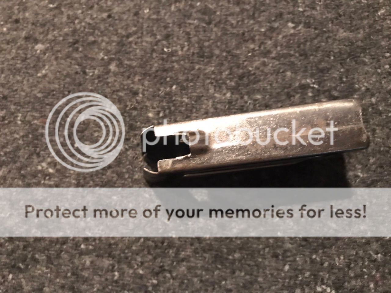

She runs! I was able to make ammo and modify an m95 clip to work, I’ve attached pics for any one interested. In the ammo pic from top to bottom is 303 Brit, 7.62x54r, and “7.62x55r”
Yes, a bit of file work and it fits no problem. I’m going to load up a fair amount of ammo and take it out shooting this weekend
