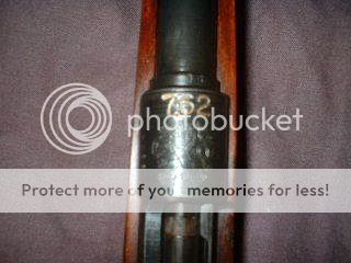

i would like to turn this rifle back to original wood and metal. Any one have some parts?
K98 Israeli 7.62 Conversion
Does your rear sight assembly still retain the ring that holds the top wood in place?
If it does, then just wait for a wood set to come up for sale on the site.
That is such a nice looking sporter I would be tempted to leave it as is.
It is hard to tell from the photos but it looks like bubba did a pretty good job on this one.
I had one exactly like it - sported the same. Someone must have done a pile of them years ago. BTW - I believe that is a Czech rifle, if thats a lion stamped on the receiver ring...
From my research...Its a K98 brno . w/ nazi markings. Czech captured and lion stamped, then sold to the Isreali's who converted them to 7.62 during the war of independance. Correct me if I'm wrong.

It would appear as though the Israeli's originally brought rifles from Czechoslovakia after the war in 8mm and later on converted them to 7.62mm. The rifles seem to be a mixture of Czech or German production, usually with a mixture of parts. The stamped "wintertriggers" appears to have been a late war modification which due to a huge supply of them were used on rifles built and/or assembled after the war. I have however also seen some really nice Czech M98k mausers made with the regular milled trigger guards and mag plates.
The FN produced K98s for Israel have a large Star of David Crest, and I am unsure whether they were originally manufactured in just one or both of the 8mm and 7.62 chamberings. FN appears to have produced these rifles well into the 1950s, so it is possible that the latter rifles were made in the newer chambering.
There are also Israeli .22LR chambered M98k rifles that usually carry a Remington barrel. These seem to be predominantly Czech rifles chosen for conversion.
Some surplus Israeli rifles seem to have been bought up by Importers once retired from their service, while others were sold off to South and Central American countries were they were used (and all to often abused) until they were surplused an bought up by importers. Thus condition can vary widely.

Israeli 7.62 K98's
I have 10 or 12 Israeli K98's in my collection and as previously stated there seems to be quite a few Czech manufactured rifles. German rifles are numerous, but the four FN manufactured 7.62 rifles for Israel have Belgium proofed 7.62 barrels. In the Mauser Rifle book by Ball, he suggests the FN Mausers were manufactured in 7.62. The other 7.62 Mausers in the Israeli arsenals the Czech, and German barrels have different barrel markings than the FN models. I have one German K98 with Israeli Markings but never converted to 7.62. I thought they converted all their Mausers but they seem to have missed this one.
The one thing I have found different on the FN manufactured K98's is the thickness of the fore stock and top wood. The stocks seem to be thicker on the FN manufactured K98's. I haven't compared the stock or barrel band dimensions of the different Mausers yet but I hope to soon. Micrometer is broke and am waiting for a new one when they come on sale.
