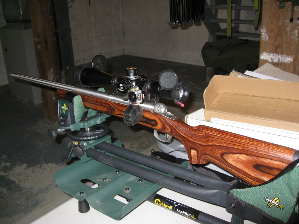

Help with load development on Savage Model 12 FCV
Try Varget and 69gr SMK's in that 1:9 twist. 23-26grs with the bullets seated .015-.020 off the lands.

led sled = load development.
Yup! And buy once cry once. That's what I did when I got the high end model of the Lead Sled. I've also got a Model 12 in 223 but in the 1:7" twist.
