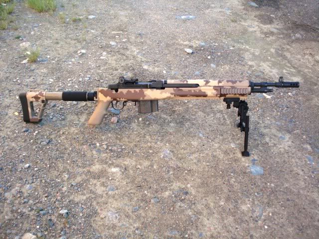

You want to build one like this ... ;)

- McMillan folder stock
- Norinco receiver
- Norinco gas system
- USGI Barrel(M14Doctor installed)
- SMITH ENT muzzlebrake
- USGI Spring
- Tartan Tactical spring guide
- USGI bolt
- USGI trigger group
- GG&G bi-pod
Going to use either a ARMS #18 mount or find a Sadlak mount. Not sure what scope to go with ... possibly Mark 4 MR/T 1.5-5x20mm M2 (30mm) Matte Illuminated or a Vortex ... possibly a Millett ... I haven't decided and still need to bed the rifle, weld the front end, paint the metal parts ... she's not finished yet.
