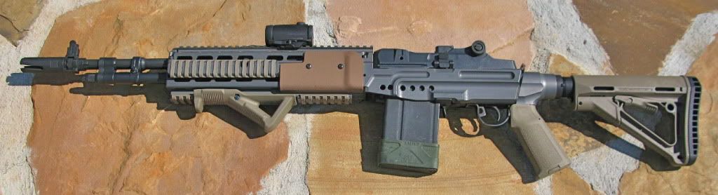

Help with my General Purpose M1A Build
Any suggestions for improvement on this build? Any upgrades seem unnecessary?
Does medium weight barrel make a big difference in accuracy (its an extra 1.5 pounds). Would it considerably reduce recoil?
To me it seems like a well-thougt package.
The extended rail should be among the extra because LRB will not sell a M25 without their standard rail. Beside you don't need the extended rail for that scope. But it could allow you to mount other accessories.
You didn't specify any front sight?
It seems the medium profile makes a noticeable difference in accuracy. But in weigth too. Do you want a carry rifle that shoots good enough or a heavier precision rifle?
Recoil? You already chose a muzzle-brake over a flash-hider. If you can carry it, you can shoot it! It's not a concern unless you want to empty your short mag at a C7 rate?! :p

Nice rifle!
I'm thinking of putting this into M14 doctors carbon fiber stock or Vltor stock (again lightweight). I like the idea of having a carbon fiber stock but I am concerned about durability of it.

Is standard weight barrel 18.5" much worse in accuracy than medium weight 18.5" barrel both chrome lined?

Last issue I'm thinking of is medium or standard barrel. I think I will prob go with standard barrel for weight reduction. I just hope that accuracy isn't much worse because of this choice. I am putting a 1x4 scope on it so its not like its designed for anything more than 4-500 yards MAX anyway.
