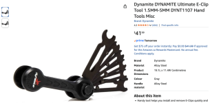

Found this little gadget last night that appears to be dedicated to dealing with these clips and if the screw driver trick mentioned doesn't work out for me I'll give one of these a go.
https://www.amazon.ca/dp/B07XG91TS9?ref=ppx_yo2ov_dt_b_fed_asin_title
I'm sure it's made from the finest pot metal and melted down spare parts that money can buy. Appreciate the replies and advice so far with this.
