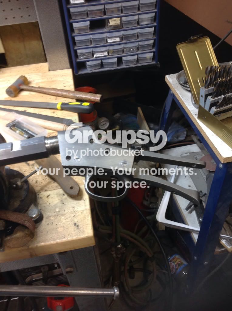

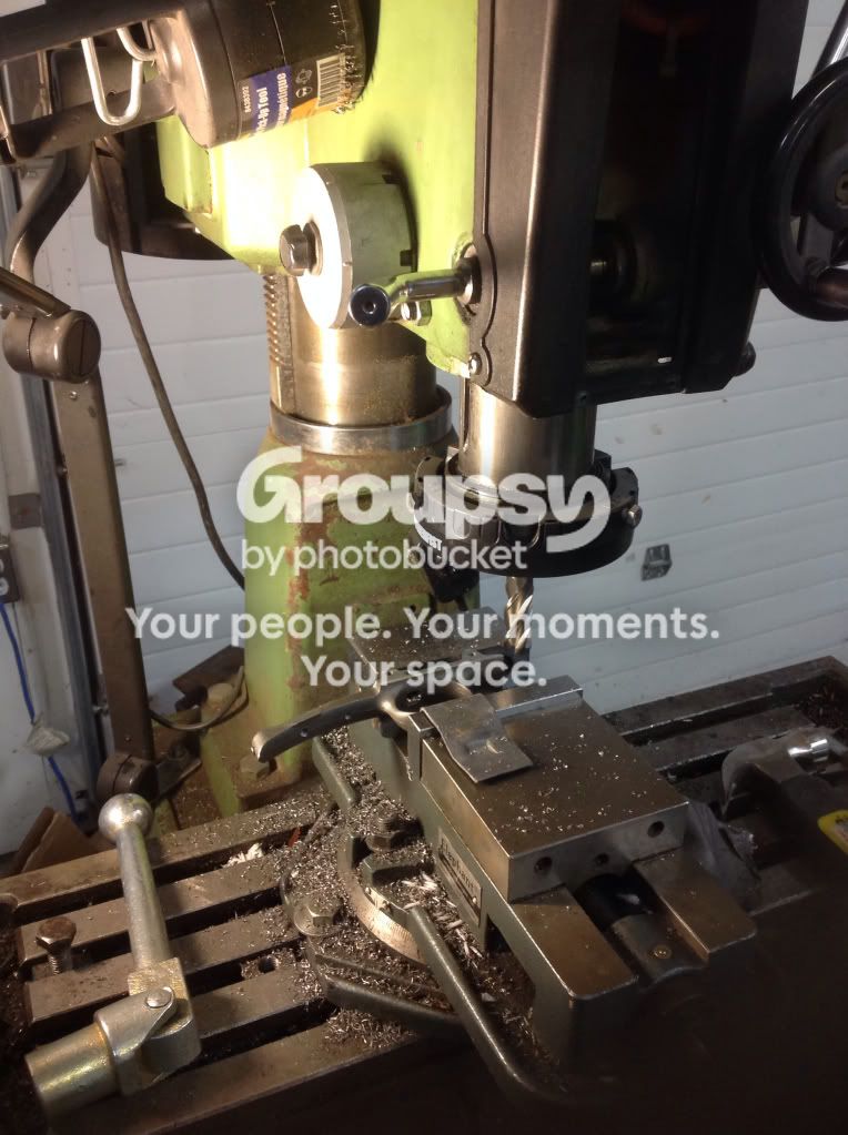

I purchased a Hepburn castings kit from a fellow gunnutter and just got started on the project. So far I have milled the trigger guard to the exact width needed and screwed it into the action. It was a very tight fit, but so far everything lines up. I also started shaping the outside of the action but didn't take a picture after that process. I am planning on barreling it with a green mountain barrel in 40-65 and will be turning the barrel to half octagon and finishing it to 30" in a #3 weight. I am looking forward to finding time over the next year to build this baby. Next is fitting the trigger but need to order a #22 reamer before I can proceed.
