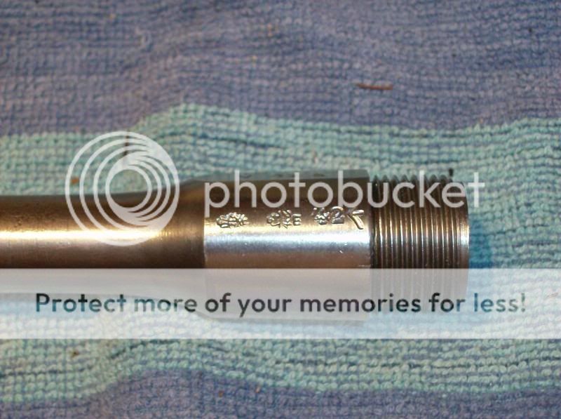

Here's a neat find - a NEW No1Mk3 barrel.

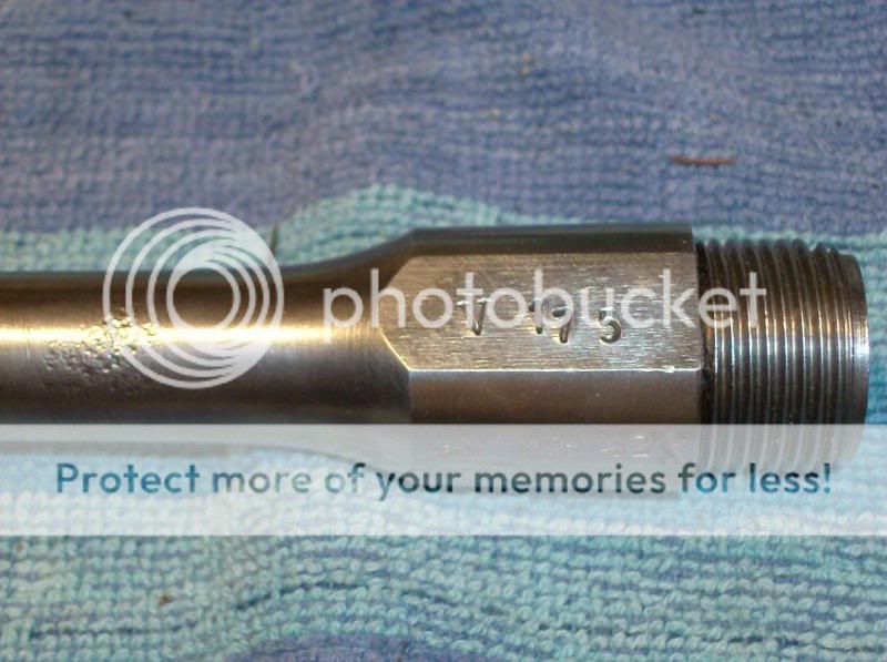

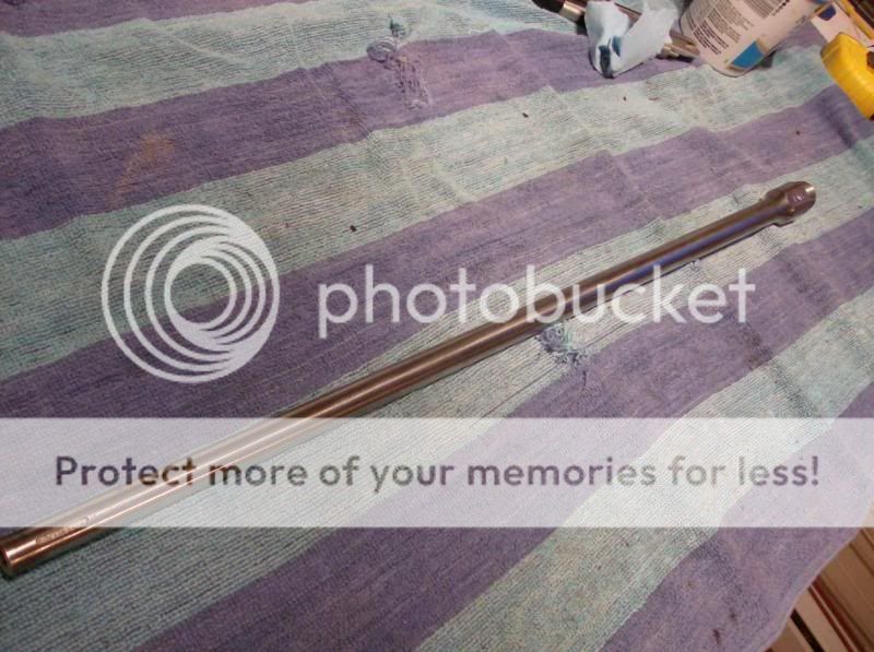

Well here's something which a fine fellow in BC accepted to sell me. Sure looks nice...

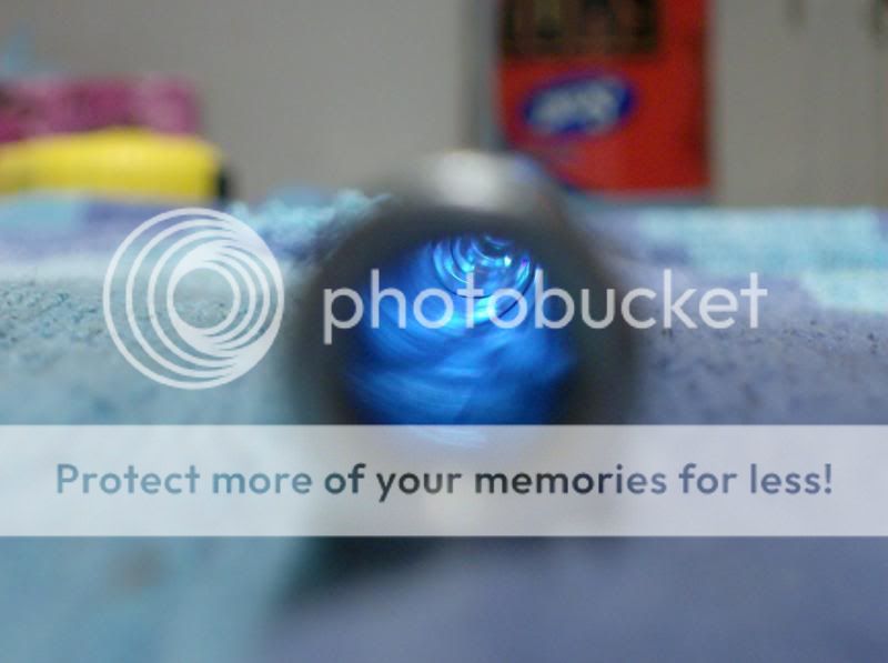

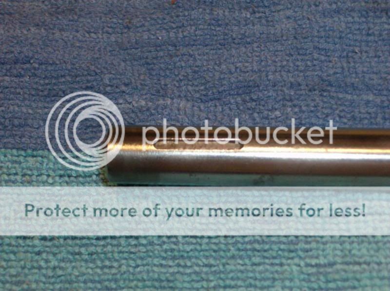

There's pitting near the knox, which is weird; everything else on the barrel looks untouched. No rear sight base pin hole, no wear mark anywhere. rifling is, well, new.
Now I need to find a really, really nice action... the search never ends. :D

Here's a pic which shows the pitting.
Lou,

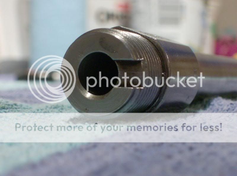

Could that be a new replacement P14 barrel? They have the front base key that would fit into that slot at the muzzle and wouldn't have a hole for the rear sight base as it was on the receiver?
Ian
Edit, Nevermind, I see the flat on top of the knox now and P14's didn't have that...

Nice find! The bore of the last Lithgow I found was still packed in grease and appears possibly unfired. (Aside from testing) 1917 barrel on a 1916 action. Never in my life have I seen such a shiny bore on an old warhorse. No ftr or sold out of service marks either. Far as I can figure it got the new barrel when it acquired the HV and SC stamps behind a replacement rear sight.

It looks to have a bright finish. Has it not been blued or has it been polished off. Also curious about the V175 stamped on the flat. I had a English dispersal rifle stamped similarly but I can't recall exactly.
How are you skills at fitting and cross pinning the sights. That can be delicate.

HarryD, I will not trust my young, inexperienced hands with that task - It likely will be Jason Spencer at Gunco who'll do the drilling (and tapping - for the rear sight base screw...)

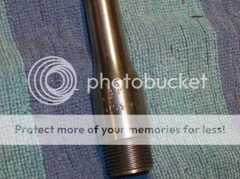

Hi Lou, don't want to bust you balloon there, but this is not a new un-issued barrel! it was at one time installed and serial numbered and proofed. I have seen new SMLE barrels in the wrap and none had serial numbers or proof stamps on them, they were almost absent of markings and pre-blued/browned. Somebody took this very nice condition barrel off a rifle and buffered/stripped the finish off it.

Far more likely to be a barrel that some twit took the finish off of. A new barrel would not be pitted. Pitting means extensive rusting.
